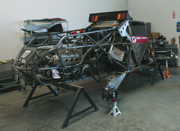

Oh! You meant the racer... ;)
It's a 4 or so year old Jimco chassis. Race prepped vette motor making over 500 HP, torque converter clutch crash box 5 speed, etc. It's on jack stands being prepared for its next race. The best looking racer in the shop isn't in these photos...
HA!! When I first posted, I wrote "I like the looks of whatever is lurking in the background of this pic" ... and then I clicked the pic after I had posted... and realized that maybe I should qualify that statement with the word "vehicle" .... LOL But now that you mention it... ! I can see you have every reason to be quite proud :ylsmoke:

Hey, I'm waiting - where's the pics? :p
Couldn't resist on the lurking bit. Too good of a straight line...
I'll see if it is in the shop when I go back up there tomorrow. If so, I'll try to get a shot of it.
