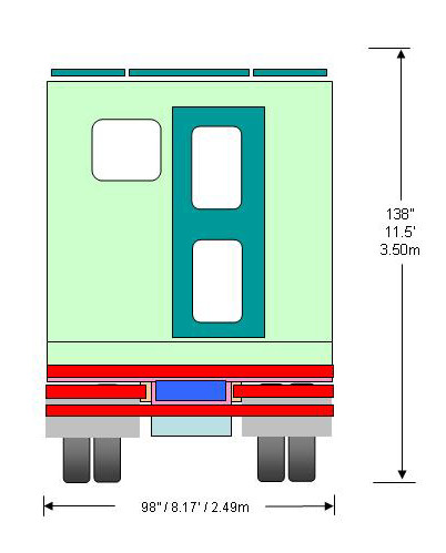

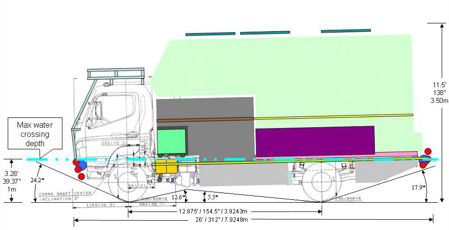

These are our current best estimates on dimensions. We should end up pretty close to these measurements.
We will be about 18-24" longer than I'd hoped and have more rear overhang that I'd have preferred. We did pretty good on centering the mass on the chassis, so the handling will probably be OK, but there will be a lot of length swinging around aft of the rear axle when making turns in small villages.

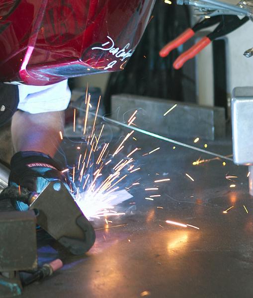

pivot frame might not be stought enough.
This is a tack welded version of the pivot frame we used to test the fit.
In terms of material, it's actually bigger stock than used in previous 3 point pivot frames on the FG chassis (check examples here).
