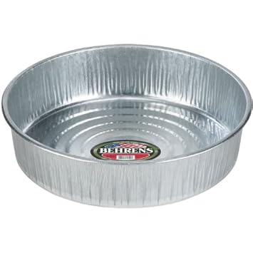

- Galvanized Radiator Drain Pan

I've used a galvanized oil drain pan to contain charcoal briquettes for dutch oven cooking and small campfires, like this:
My improvised galvanized fire pan has never become hot enough to create a risk of exposure to zinc oxide fumes. While the risk of such exposure is a concern at welding temperatures, the risk is almost non-existent in stoves or fire pans. This post explains why not: http://donkey32.proboards.com/thread/373/afraid-galvanized-pipe-anyways
