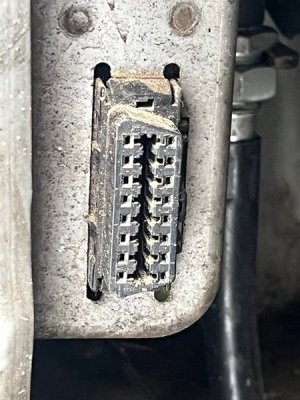

Check Engine Light has returned. Twice now upon start up the CEL comes on and the engine doesn't respond to any throttle input. Turn the key off, restart and the CEL is not on and throttle input is normal. Thoughts?
I have to look for the connectors for "blink" testing, but didn't immediately see them once the dash was removed.
Another update. Tonight after work I went to start the truck and it started, but the check engine light came on and no RPM above 1,000. Turned it off and restarted the truck 4 or 5 times and every time the check engine light was on and low on power, but on the 6th cycle no check engine light and the engine rev'd normally.
I hate guessing and would like to at least have some direction other than reading it could be a TPS, but why randomly? Where are the wires located on a 2005 model year to do the blink test? I looked and didn't see anything that looked like the connectors in that video. Also, I have two OBD ports, one on the left (driver's) side low by the A pillar and another as part of the fuse box in the center of the vehicle. The center one is referenced in the FSM where you connect the Mitsubishi tester, but nothing about the other OBD port. IMG_1560.jpgIMG_1561.jpgIMG_1559.jpgIMG_1558.jpgIMG_1557.jpg
And another question, are the OBDII scan tools different between cars and heavy-duty trucks? Seems so, but I thought I'd ask. Any scanners that work with the Fuso that are not the Autel and cost thousands of dollars? I wouldn't be opposed to spending a few hundred dollars if I knew the scanner actually worked.
Don't let the fact that there is an OBDII plug fool you.
Sadly, the data that comes out of the 2010 and earlier Fuso Canters ECUs (with the 4M50 engine) is propriety and not OBDII compliant.
Personally, I have tried over a half dozen different scan tools, with no success.
Having said that, the use of some scan tools, along with an app like Torque, can allow for the deletion of error codes.
Yeah, my searching Google and the forums is turning up that the older models, with the 4M50, aren't as easy to diagnose. My FSM shows the factory test scanner with all kinds of dongles and cables hooked up to varies connectors. The good in all of this is this isn't a pressing issue as the truck will not be on the road until I complete the cab swap. In swapping the cab all of the electrical connectors will be cleaned as will all grounds, so if a bad connection that may resolve the issue. If not then I have read a "dead" pedal can be from a bad TPS or a boost sensor.

Not sure that is the right scan tool.
For my 2010 FG84, which is pretty much the same as the FG140 in the US, the correct scan tool is the MUT-III, not the MUT-II.
You can get Chinese clones of this scan tool, but there's no guarantee that they will function in the same way as the genuine ones.
I will add, a genuine MUT-III scanner is around AU$8K, if you can buy one (they are normally only sold to dealers).
