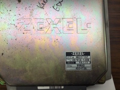

The shop is not very communicative so I don't know exactly what the tech did. But the shop is the only shop within hundreds of miles which has the Mitsubishi software capable of diagnosing and interacting with the truck (to my knowledge). The service manager did say initially that a new computer was available from Japan but would cost $5k (and was not returnable) so he was looking for a used one. Later he said a new one wasn't available. The corrosion/random ******** happening is an interesting hypothesis since very early after I took it to them they thought they had fixed it and then it started acting up again. I have no idea if they opened the ECU to check its condition. I wish I could do the diagnosis and repair myself but I live in the center of Denver and don't have any place to do the work.
From that pic, I'm guessing you have the FG639 with a 5 speed?
That ECU was also used in the FE639 5 speed for the same years. The ECU for the automatic version of the FE639 for the same years is MK327409. A quick scan on ebay for that part number shows 2 ECUs available.
If I were in the same situation as you, I'd give one of these eBay ECUs a shot.
Yes.
Do you think an automatic ecu will function correctly with the 5 spd?
