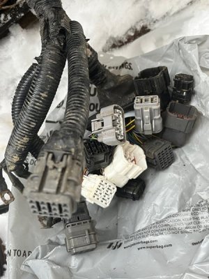

I am having a random CEL come on with no power. Not going into limp mode where you can still drive under reduced power, but zero RPM response from throttle input. I have been reading every thread I can find on causes and remedies and I found one thread where the owner replaced just about every electrical sensor, cam tensioner, cleaned grounds, ran jumper wires for suspect circuits, and cleaned most connectors, but what seemed to be the fix was cleaning all of the electrical connectors that connect the frame/engine harness to the body harness. I just wonder if this gets overlooked a lot of times. The owner in that thread did state that he found corrosion there and cleaning them seemed to fix his issues.
If there is evidence of salt spray on any part of the chassis, one could also assume that salt would probably get into the electrical connections and cause corrosion.
These are the connections between the body (ECM) and the powertrain from a 2005 Fuso. These connections are 21 years old and even older in your case Kerry. Just think about what havoc it would mean if even one or two of these connections has a bit of corrosion and what that would do to the vehicle's computer. For me, before testing and replacing any sensors I would thoroughly clean every ground and every connector and reassembly with dialectic grease.
Given that it is quite painful and time consuming depinning connectors, plus the fact you can really screw up things if you reassemble them incorrectly, one in place option is to use a vinegar and salt solution in cup to dissolve any corrosion from the terminals, followed up by using another cup with a bicarb soda solution to neutralize the acid. I normally do a rinse with clean water after cleaning with the vinegar, then do the bicarb thing.
If you want to go further, you can use something like MG Chemicals liquid tin, which will add a coating of tin to the cleaned terminals, which will further reduce the possibility of future corrosion occurring. I should add, this stuff is not what I would consider cheap, but in this instance, you get what you pay for.
And as mentioned, if you use some dielectric grease when reinstalling, that will also be beneficial.
I know it should be common sense, but obviously you need to fully dry the connectors before adding the dielectric grease and reassembling them. :oops:
Yeah, I wouldn't even fathom depinning. Cleaning in place is what I will do. I already knew about the vinegar and sodium bicarb treatment but never heard of liquid tin. Something to look into.
