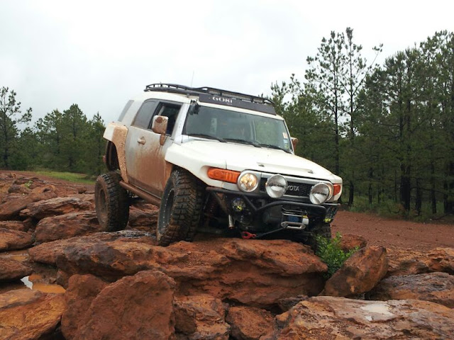

FJLED
Is that a go pro mounted I see on the pass side beam?
If so, lets see some footage!
Strong work on the build.
Unfortunately, I was pretty inept at the timing of taking the video and killed the one camera that was on the suspension. Guess there was an issue with the water proof seal on the one housing. As such there was really only ~5 minutes of worthwhile video (didn't get rock garden and the trail riding is pretty boring). Luckily some of the folks I was with caught video on their cell phones. No tuning on the suspension and no weight on the rear end (bumper or storage setup). The reservoir slid low in the mount (realized in the rock garden), but in the video you can see that caused the hose to contact the UCA.
