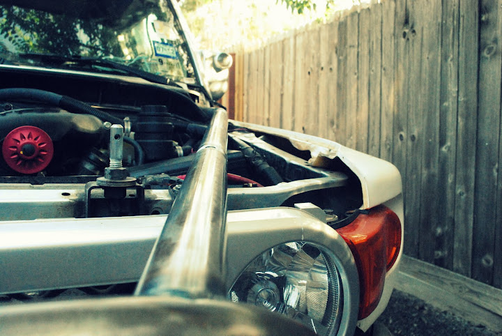

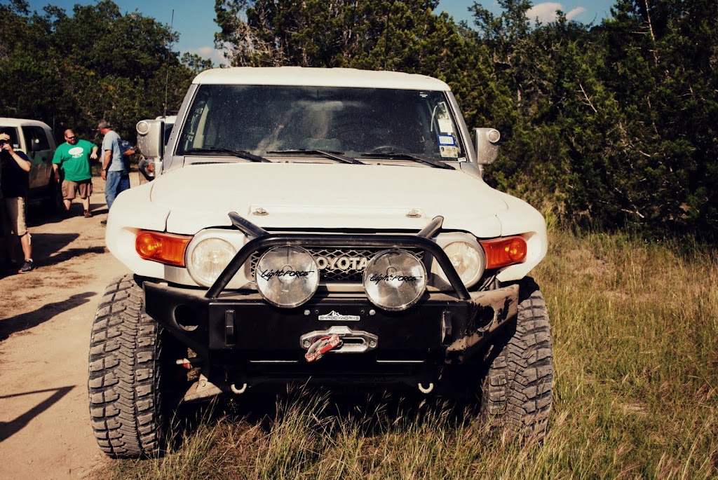

Been awhile since I logged on here and there have been a few updates. I'll run back to see where I left off in April, but here's the new shrockworks bumper on it.
Still more tube work to be done, but where it stands now...

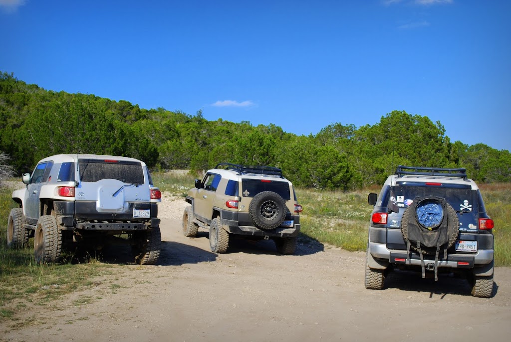

I love how that thing looks from behind! :D Especially without the spare tire. Plan to put anything there in its place? I made a MFC holder. Just haven't had the time build the internal spare tire mount and swap them out. Amazing work.

No plans for the rear door yet. The rear end needs to be lowered down a bit. That means putting a fuel cell inside, 4 link the rear, bypasses, and some frame modifications for more uptravel. Inside will be getting a cage which will likely hold the spare. Guessing I'll keep the rear door (I like my closed cab AC, haha), but have thought about removing and doing tubework to hold the spare there.
