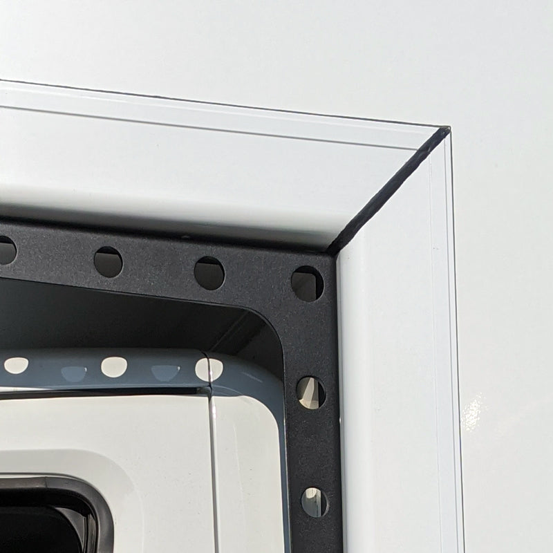

mexjtc
Here you go. Total Composites makes them for their boxes.
