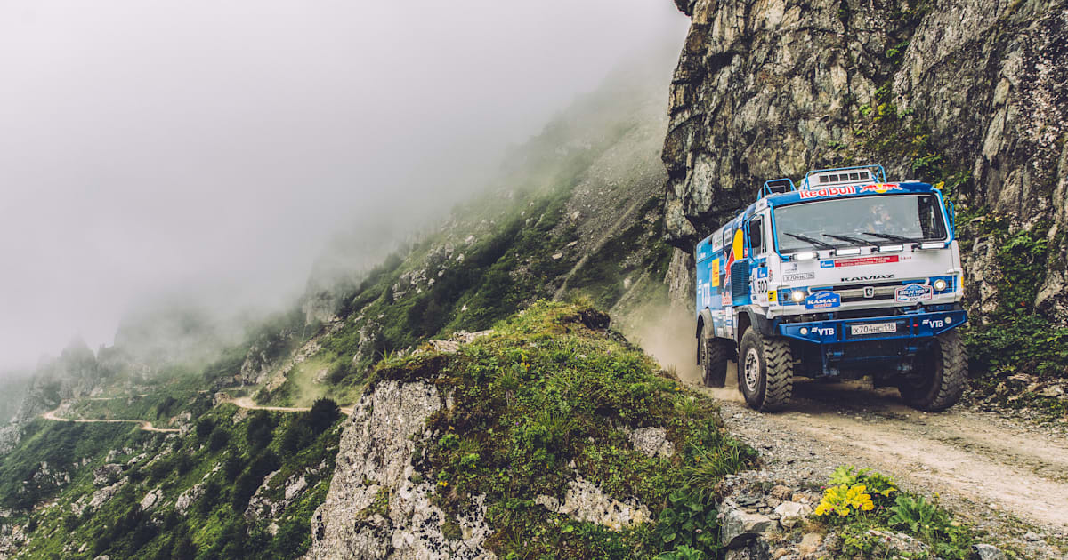

This is true for every truck frame, unibody car chassis, mountain bike, trophy truck, side-by-side, go-kart, race car and trailer on the planet. A frame/chassis is not suspension, neither is a 3 or 4 point mount. Both are undamped springs.
Focus on proper suspension, instead of frame twist or allowing a 2,000 to 3,000-pound box to flop side-to-side.
Millions of lorries/box trucks travel millions of collective miles each year with U-bolts holding boxes, which often sit on hardwood timbers, to heavy frame rails.
Do LMTV/FMTV or old Deuce and a half type trucks have a 4-point sub frame? Does a bus or motor coach have one? Does a HEMTT, HET, HMWWV, or Caiman/MRAP have one? Does the multi-time Dakar-winning Kamaz Master Team truck have one? How about Torsus' Praetorian?
To the best of my knowledge, not a single one of them does. All of them either carry heavy loads or travel off road, or in some cases, do both.
Don't get caught up in doing what hegemony tells you to do.
