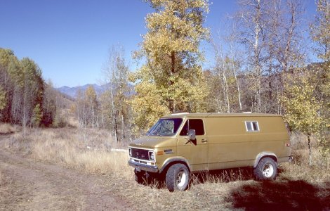

First real off pavement trip after I bought it 6 years ago.
