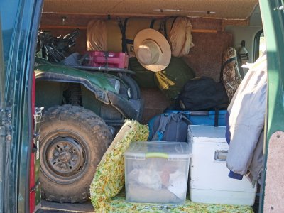

Agreed, I did my own conversion from a passenger van and have about 60k total in the van I think. Started with a bone stock 2011 Quigley with 100k miles, paid $20k.
Biggest expense for me by far was the pop top.
