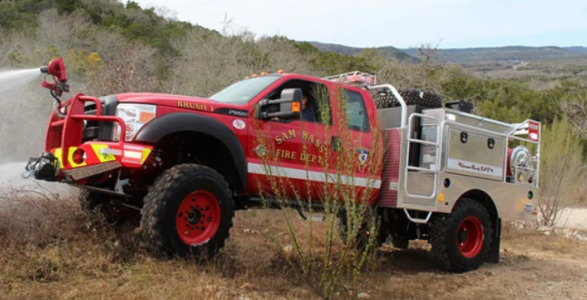

Chassis cab trucks are built to carry heavier loads than pickups (GVWRs 14k - 22k). My rural FDs run F450 and F550. These same trucks are often decked out as wildland fire engines which carry 300-400 gals of water plus PTO driven pumps, plumbing, winches, brush guards, hand tools, etc (vehicle weight 16k-19k). The heavy frames on those chassis cab trucks provide no noticable flex when carrying one of my big boxes of air, configured as a mobile command center (or camper).

Frame twist will be evident when 2 diagonal tires are carrying all the load. Even newer F550s are boxed under the cab, but C channel in back, and will readily twist unless some structure is resisting that motion. Most chassis designed to carry heavy loads are made this way.
