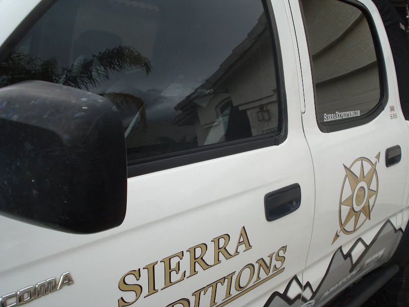

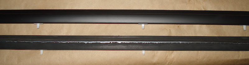

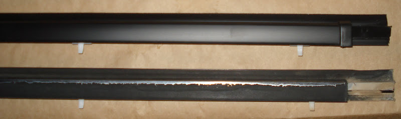

I also replaced all of my windows trim panels, I had a few missing pieces from trees running down the sides of my truck, and the black paint was starting to peel leaving exposed chrome! Chromaphobia was kicking in full throttle.
Here you can see new vs. old:
Here you can see where a tree had ripped off one of the exterior clips that hold the molding.
I will come back and edit this post once I get pics... but I think you can get the point... back to like new.
EDIT: Here is the new trim pieces on:
