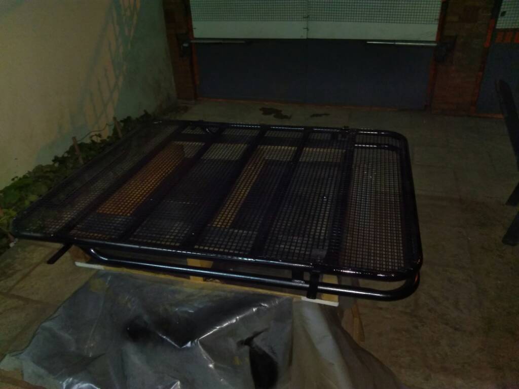

Got this roof rack for the suv it was making a Lot of noise, then i welder some artistic sheet metal and got quiet as a tomb
Enviado desde mi S60 mediante Tapatalk
