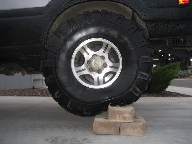

Who says these tires are too stiff and won't flex?
This is 10lbs of air in there, I imagine I could go lower.

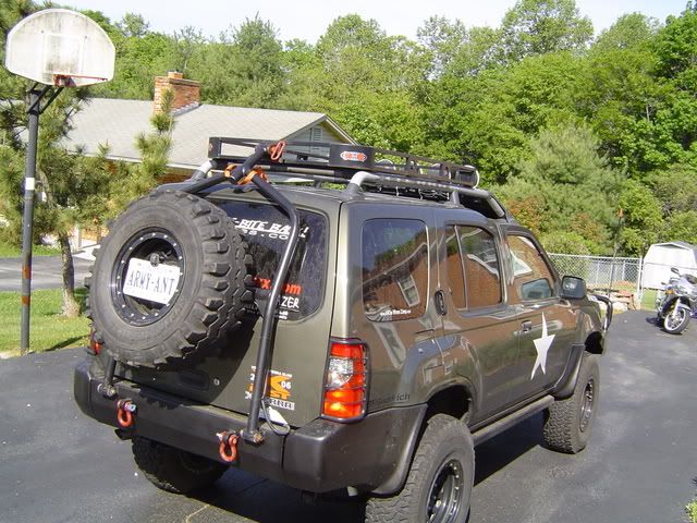

Xface that's a really nice spare carrier...must make it a lot easier to get the tire up and down.
