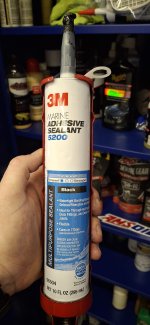

I wonder if marine sealant would work well for something like that. It's not only a sealant, but it bonds as well. I've use it with alot of success on many different things.
