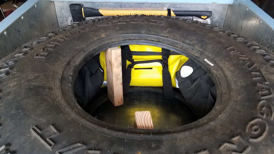

A little bit different from what we typically see here on expo, but this is how I store a LARGE amount of additional gear on my #LX45
#1. Yes, I have made the decision to not carry a spare wheel. I run a heavy aluminum beadlock style rim which is generally a lot stronger on the other edge, and also make it a bit easier to change a tire.
On more difficult trails, I find rearward and over the shoulder visibility key. Having the spare tire laid down in the bed drastically helps this along with keeping the weight low for stability. The downside to running a 40" tire is that a spare tire takes up a HUGE amount of volume. The amount of storage volume inside the tire is frankly amazing. I am able to fit 4-5 of my waterproof #TitanToolBags inside the tire. When full they are almost a perfect match for the inner diameter of the tire. It helps to have a few sections of wood 2x4 to spread the tire beads which makes getting the bags in/out easier on the fingers (and the wood also functions as jack cribbing or emergency fire kindling). I even found a round 'super' cooler that fits inside the rim hole! With the straps run through loops on the cooler, I don't have to undo anything to access the cooler during the day.
The gear inside the tire isn't my day to day gear. I usually keep 4 bags in the tire.....Tools, vehicle spare parts, spare fluids, and a 'fix-it-kit'. My recovery bag goes behind the driver seat along with my recovery rope. For camping trips, there is enough room ahead of the spare tire for two large dry bags for camping gear.
I thought I would share this to help people keep thinking in different directions as far as efficient gear storage.

I find the no rim and storage space inside a good idea in the right use. I understand that most of you carry the necessary tools to mount and unmount wheels but for my uses right now this just doesn't make since. I do not carry a big enough air compressor to do it, although I did recently have luck with the ratchet strap method. And more than that I prefer metal toolboxes with drawers which wouldn't go well with the shape of a tire. Lastly, I don't necessarily have the space constraints you do. My daily driver is and extended cab Canyon with a high topper so I could load that down with more than it can handle. And the 1970 is worse, its a single cab 8ft bed truck. I could carry 3 spares, toolboxes, and sleeping stuff and still have more room than many new truck beds. Really, it all depends on your needs and metcalf has definitely thought outside the box with this. Anyone else have anything similar to this? Or have any ideas that make me look like an idiot?

Lots of miles and lots of trails on this setup across multiple vehicles. I've never had to do a full tire swap in the field, but I mount/dismount all my own big tires on beadlocks anyways because tire shops shy away from them. I did finally have a single puncture on my Colorado BDR trip this summer. We ran border to border north to south on mostly dirt/gravel/rock. Had something poke a hole in the inside of the right front tire day 1-2. A single plug held for 500+ miles over the rest of the trip. In total, that trip was about 700 miles of 'dirt' that was run at about 10psi and over a thousand total.
I do recommend taking a few things that help change a tire like some medium spoon bars and a bead buster.
At this point, tire failures are a low enough occurrence for me that the juice is worth the squeeze so to speak. Being able to store ( a lot of ) equipment in the tire saves a ton of space in my packing plan.
I look at is this way, a traditional spare tire only really fixes one issue anyways, having the tools and knowledge to repair tires on the vehicle is important. The distance between having one flat vs two flats could only be your wheelbase.
I'm never in enough of a rush that changing a tire on the rim will be THAT big of a deal to me.
An interesting point that come up on another trip.....A spare tire alone can also be half way ready to swap on someone else's rim if their vehicle has a different bolt pattern than yours.
