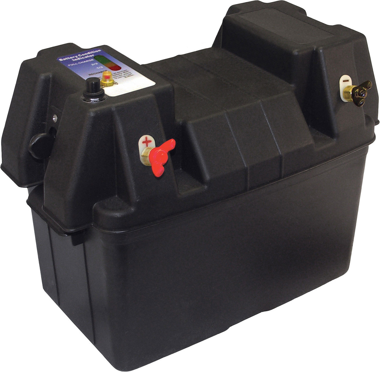

I bought a cheap batterybox around 30 dollars and put in my old AGM 70 ah battery (probably fits a 100ah there). I dont know if I can charge it via the car or a solar panel? But anyway the Goal Zero Yety 400 looks nice but is only a 33 ah battery, I have twice as much to drive my fridge at much lower cost.
As we have little strong sun here in Sweden a package like yety 400 + solar panel would not make so much since like a big 120 ah in a cheap batterybox would do for a cheaper price and not struggle with a solar panel when there are no sun with like a 33 ah battery.
What I mean is a 100 ah battery + battery box is about 150 dollars and a yety 400 is about 460 dollars with a 33 ah battery
I do not have so much money, thats why I have this box. My box only have one 12 v port. Though I have two 12V ports on my Jeep Wrangler Rubicon and two USB ports.
Similar to this. Offen You can fit a 120 ah battery in those boxes.
Anyway You can build Your one box
