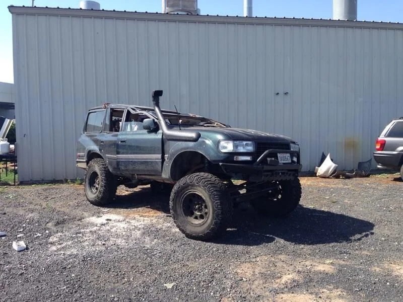

On the precleaner front I went with the same thing that always worked so well for me on the 4runner. A Donaldson Topspin. Although the 80 has a great cyclonic filter for an OEM setup I notice that the air filter is covered in dust after a long weekend of silty offroading. The "pea trap" seems to catch all of the big stuff, but I remember the days of the Donaldson pretty much keeping the air filter pristine despite offroading for a living back then. So, with a longer trip in mind I threw on an "El Cheapo" TMS snorkel and the Donaldson precleaner.
Here is the China Snorkel thread on Mud. https://forum.ih8mud.com/threads/snorkels.855952/
I think it was this picture that made me think "Yah, that knock off brand is good enough for me!" Photo and truck of "Booger Weldz"
image-jpg.1076628
The internal guts of the HD topspin are all metal unlike the normal Topspin. Not sure that it's needed, but hopefully I can bash it into more trees this way.
