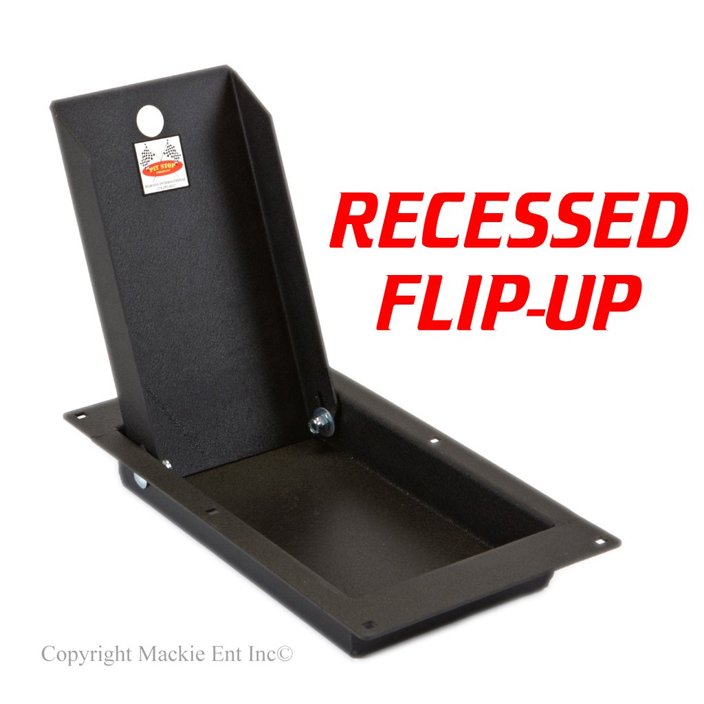

I'm also looking to put in flush mount wheel chocks like this:
