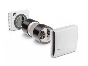

Is that the Lunos E2 or EGo?
The outside vent cover/baseplate has to line up with the internal (insulated) ducting. I believe the direction/angle of down facing exhaust can not be changed.
As Blackdogvan noted, would there be anything in the way of rotating the entire unit?
That’s why I asked whether he was using the E2 or EGo. I have the E2 in my house and there’s nothing stopping you rotating them however you want. It looks like that’s the EGo though which has two sides and I could see it being more important which way it’s oriented. Still not sure it would matter much though.
I use the EGo version. No reason I can see why it can't be rotated +- 45 degrees.
