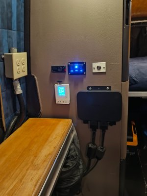

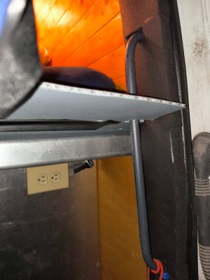

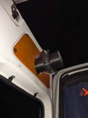

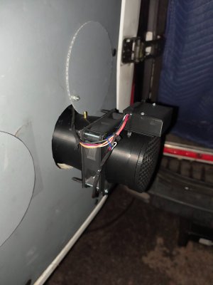

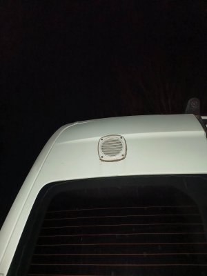

Here are a few pictures of my installation:
1. I have an automation controller that looks like a thermostat. It controls the system on a PID loop to run some special fans.
2. I run an upper and lower assembly as you can see in the pictures. This requires a divider between the top and the bottom of van to keep air from taking the short path between the assemblies.
3. I didn't want people playing with the lower exterior vent, so I made this one with an access door. You will see the upper vent in one of the pictures and yes it needed a custom wedge part to interface to the side of the van. All plastic with the exception of the vents is custom printed in ABS.

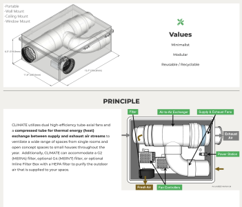

Well, now I know :-( I've discussed the Accurasee HRV's a few times in this thread and wanted to believe their Mini and Climate were the answer. Small form factor, 12V power requirement and, most important, an operating range down to -40F . When I reached out for some technical details, I got a run-around so began to look elsewhere. But I was always curious about how it was constructed and what allowed the Accurasee to remain effective at such low temps. Oddly, their website and YouTube videos never revealed photographs of the mechanicals, only drawings. So I was pleased to discover a Climate model on FB Marketplace recently, with photos!

Comparing this photo with their website images left me very disappointed. Am I being too harsh to say it looks like junk? Did I mentioned the price of $600 CAD? Anyway, the Accurasee has gone from a soft maybe to a hard NO.

It is a bit underwhelming but definitely inline with its value statement of minimalist. You cannot see most of the design/value because it is inside the PVC. The magic is hidden from view. Clearly these are not very popular and you have been thinking about this for several years so maybe it is time to find a cheap one, maybe this one, and try it out.
It looks to me that the "heat exchange" is cold air inside the metal flex passing warm air outside the flex. Total garbage.

$600 CAD is pretty ridiculous if the exchange "core" is just a piece of aluminum flex duct. Is is $600 used? or is that for a new unit?
$599 plus tax and shipping for the Climate model from the manufacturer.
Quite honestly, I suspected the seller had bodged the unit but they assured me it was “as delivered”. So I sent an inquiry to Accurasee, asking for photos instead of drawings. Although their website promised a response generally within 30 minutes during work hours, its been two days and nothing.
