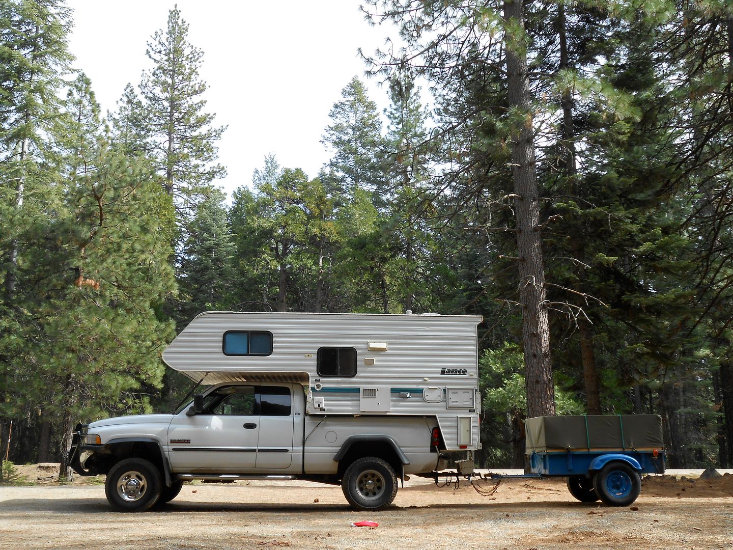

Mine WAS a 2500 with the camper package, so came with a single, thick upper secondary spring (sometimes called a upper overload) in a SRW format. That very config was the defacto forerunner to the SRW 3500. Some of the 3500 dualies of that year (and around '98-'02) came with two secondary springs on each side. A friend of mine wanted his secondaries gone from his 3500 and gave me the springs. Each of these set-ups gives a 500 pound boost to the rear axle. I dicked around trying to find the right balance in the upper secondaries and found that all six leaf springs did nicely. I still had some squat, so I added Stable Loads and that made all he difference when hauling my Lance Camper. Here are some pix of the current rear suspension format, gotten there by degrees. I just kept at it until it was right. Here's an overall with the lift block, the real overload on the bottom, a shim, three main springs, a block to separate the secondaries, a thick and two thinner secondaries (from the duallie) and four 16" long, flat top U bolts. That black/gray cube above the end is a Stable Load. These simply allow the secondaries to engage sooner as you add load.

I have a little too much rear squat since i put 3" front coil spacers on.
