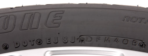

Date code is in an oval right next to the bead.
It is actually pretty easy ... once you know where to look:
Here is an example of the code
In the oval is the date code
In the example below:
DOT EJ8J DFM 408
DOT EJ8J DFM 408 Manufactured during the 40th week of the year
DOT EJ8J DFM 408 Manufactured during the 8th year of the decade
