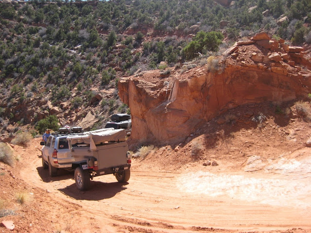

photo from my recent trip
Great pics Jim...God willing, hope to make out summer to be lucky enough to meet the "due west" crowd...always enjoy the updates!
Pretty spots, Jim.
