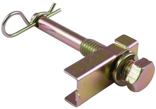

Ordered and received one of these Curt light duty anti-rattle pins to minimize swaying.
