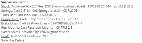

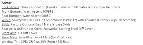

Orrr.... Speaking of exactly that.... This one is ready to go:
