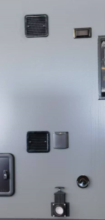

I have a 12v - 148 liter fridge freezer in the habitat. It is a wall upright model with a freezer drawer with separate door at the bottom. To be safe I need to check on the airflow ventilation engineering. A safety check.
Does anyone know how I should test this?
(in the picture below is shown two external wall vents)
