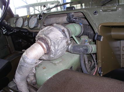

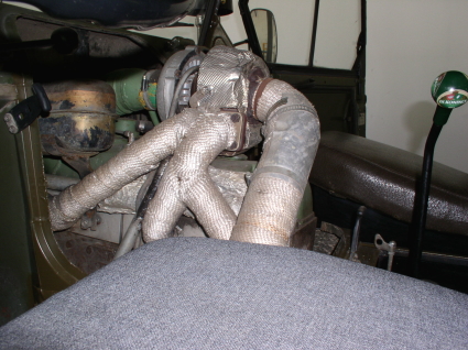

Here is an example of re-engineering the manifold, and a good view of a stock 416's tight confines. This was a turbo'd 416 Sold by Ziggy and Lisa, back when they were selling mogs.

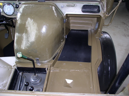

You can see this cab was also lifted, note the shifting area, is now recessed lower:
Another dead give-away is the PTO hole in the front will be higher than the PTO, and the bumper...well...further away from the grill :)
Lifting the cab has another benifit, it allows more cool air to circulate around the engine, keeping the cab cooler, also quieter. Those alone are worth the lift.
I can't speak for this unit (The Ex-NZ rail mog) but as Mike says, very common procedure on a turbo swap. Some aluminum blocks, re-route the hand throttle or extend the cable, few other minor things, and your off.
