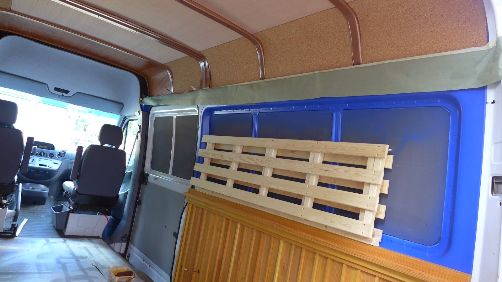

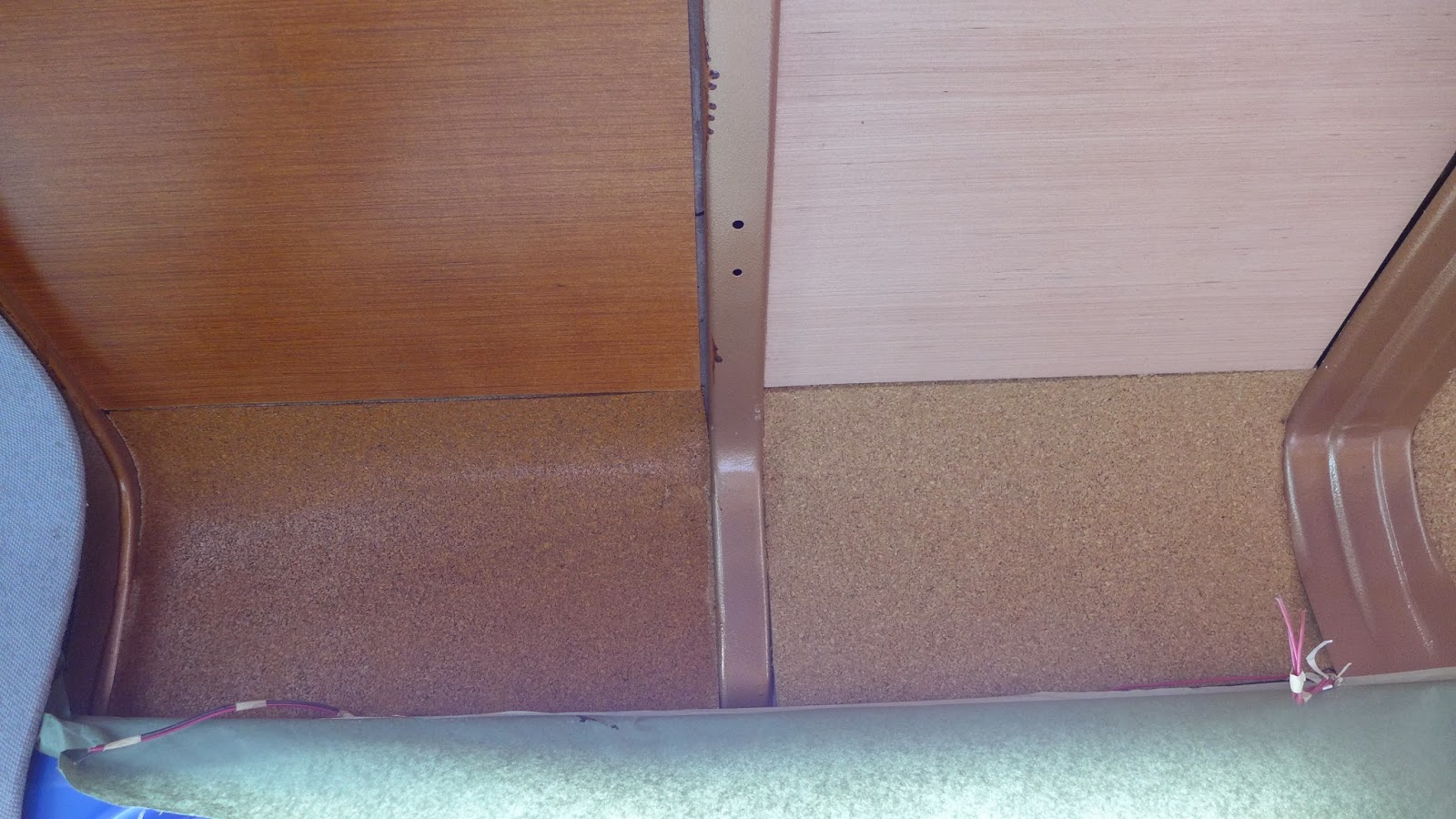

(above) The replacement contact cement canister came in to get the ceiling cork finished...
(above) Ceiling sealant - Coat # 1...

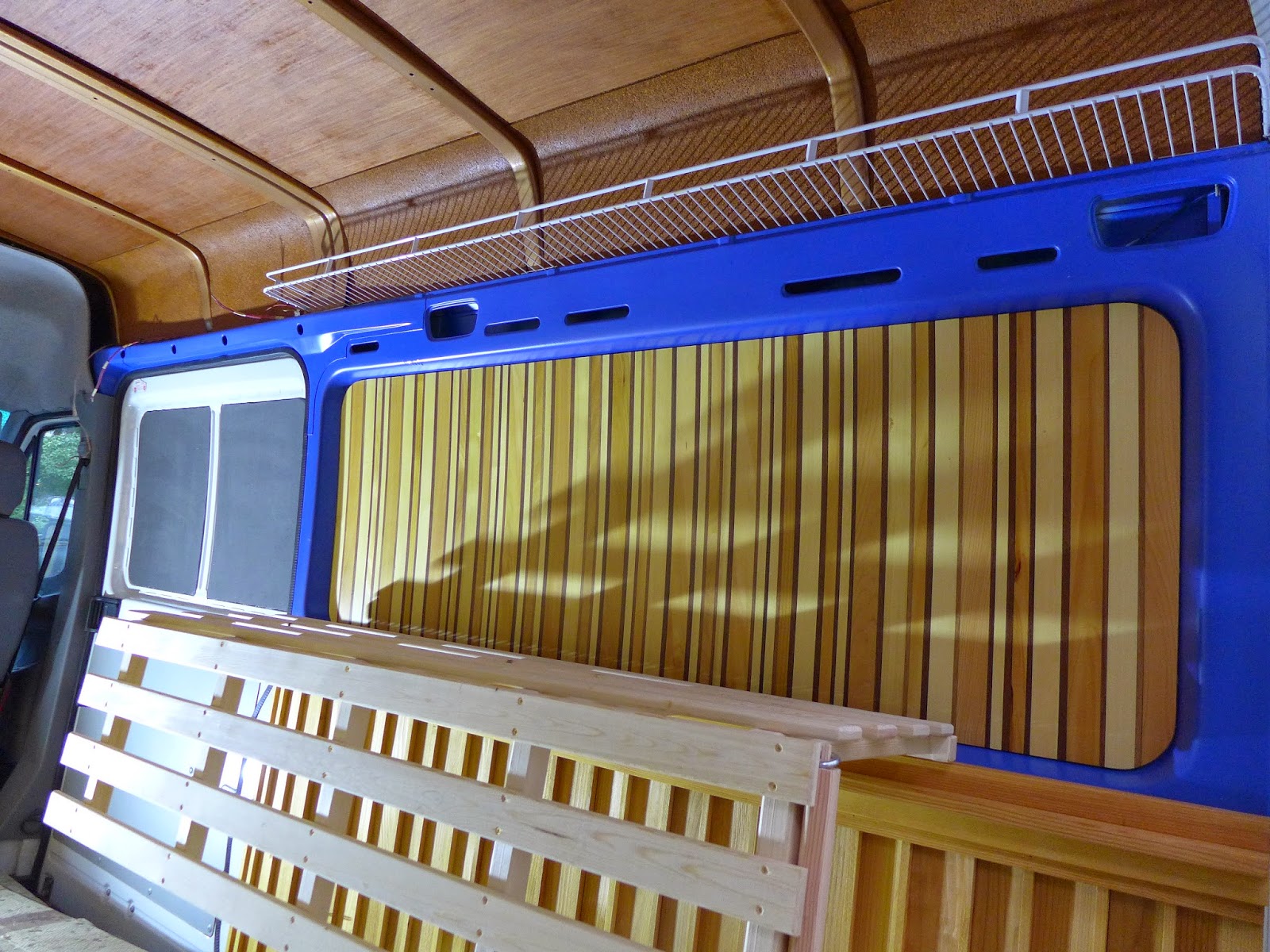

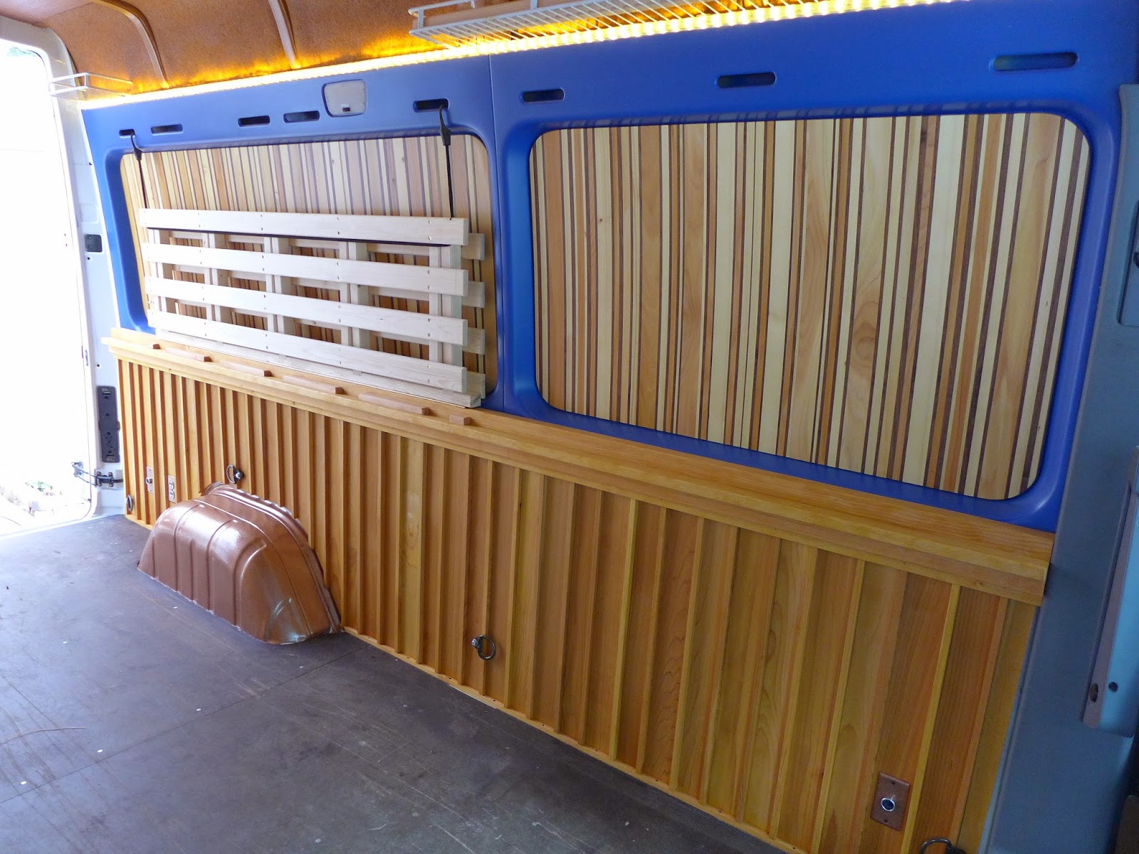

(above) The upper wall panels were fabricated while the Sprinter was absent...The 1/8" thick wood strips are contact cemented onto 1/8" plywood, then contact cemented to the underlying foam wall insulation...Three coats af satin polyurethane seal the wood...

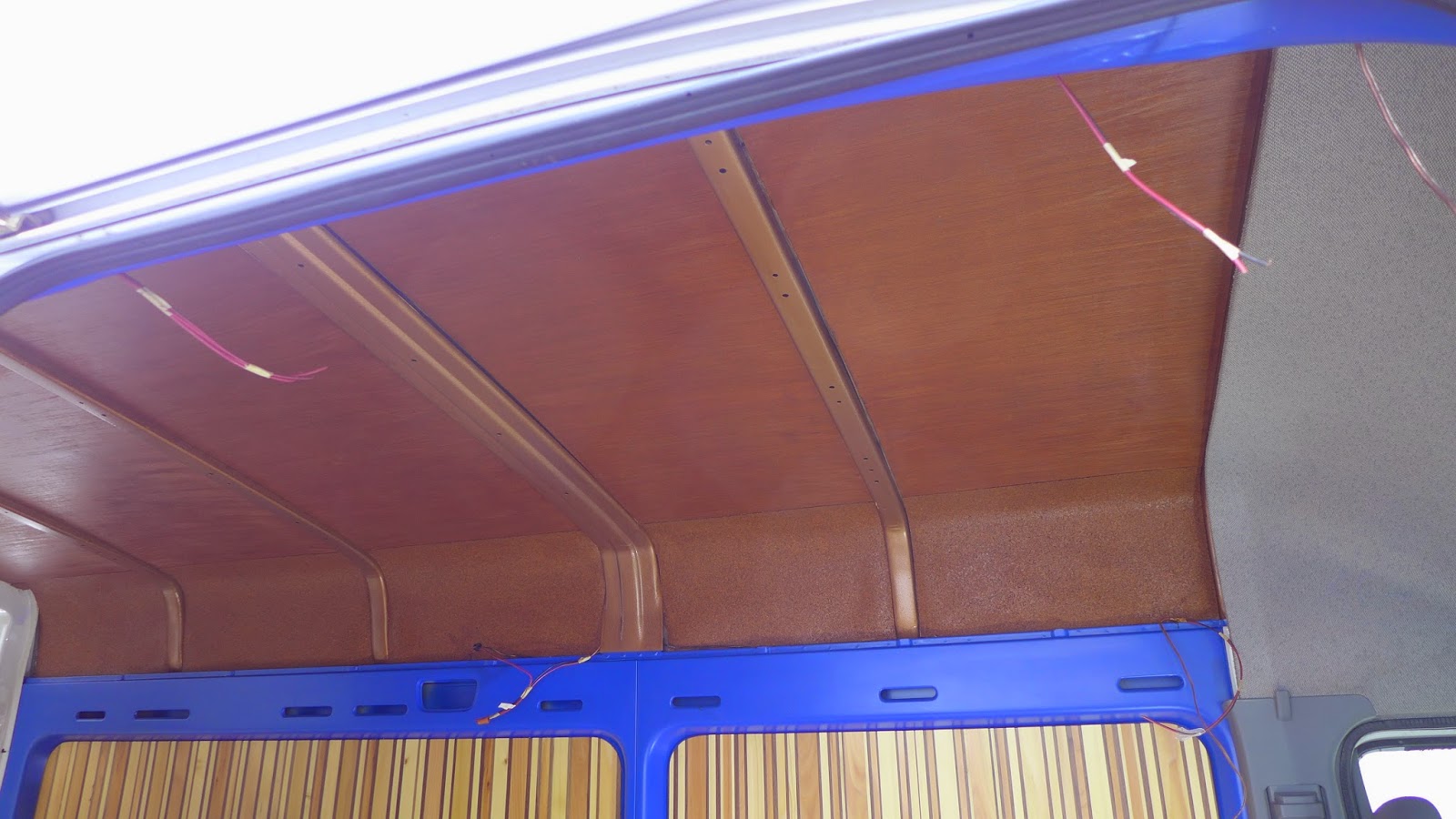

(above) Ceiling sealant - Coat # 2...

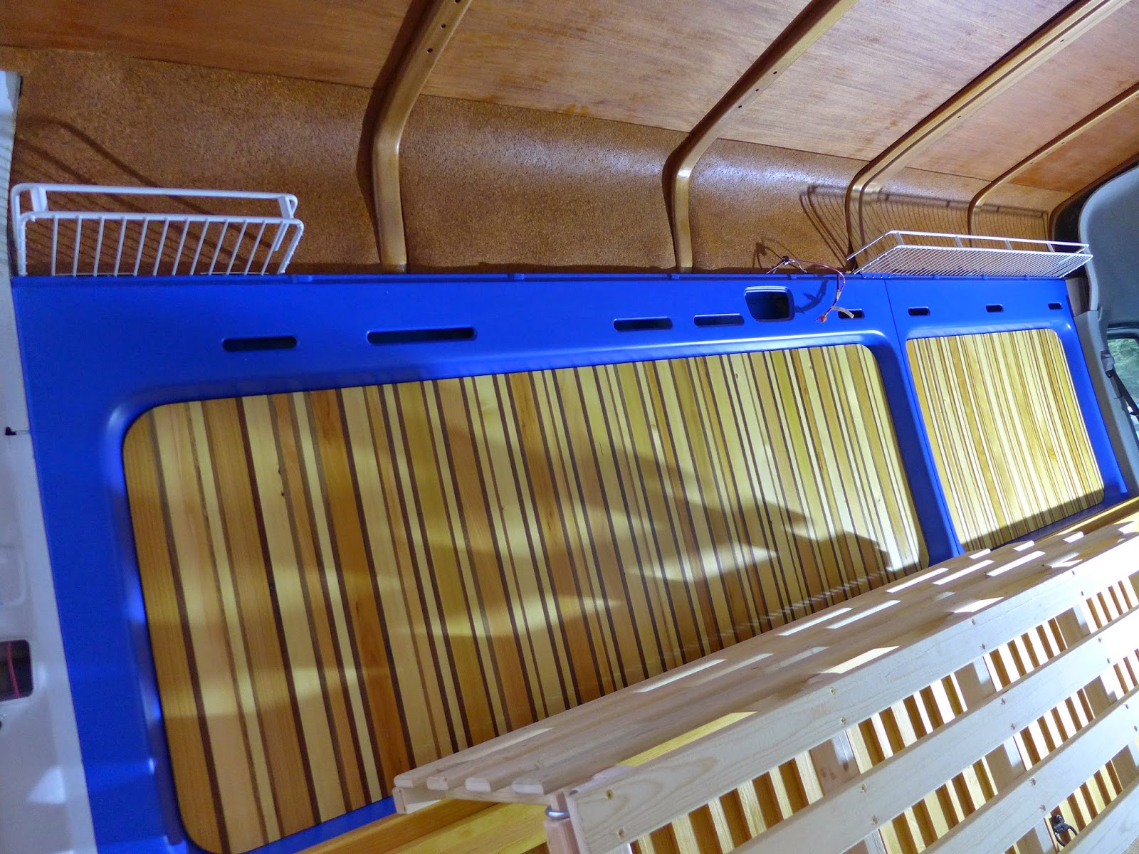

(above) Wire shelving cut in half...
(above) The bed sitting position suggests no shelving over the mattress...

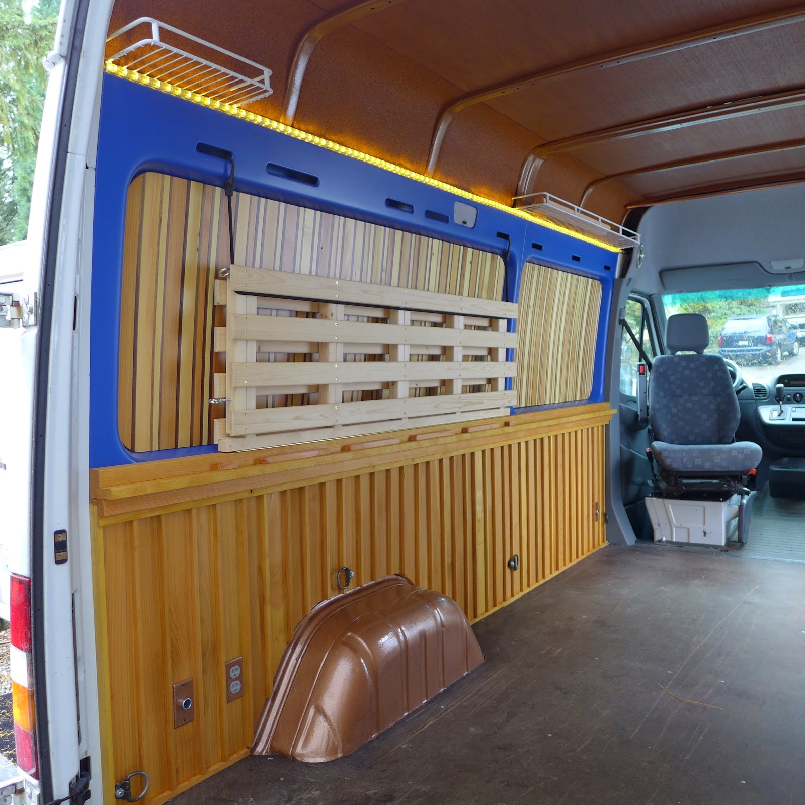

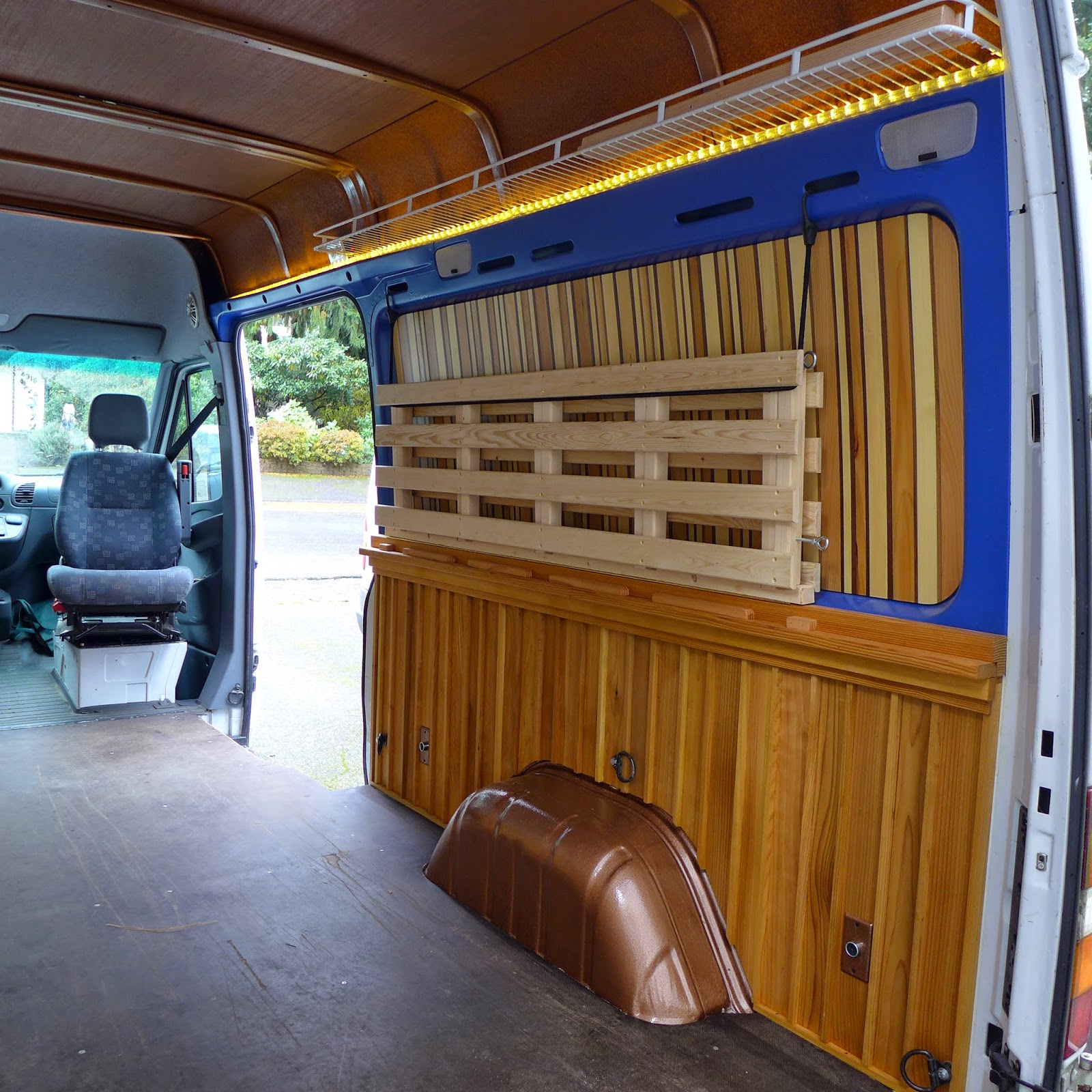

(above) All done... "Phase One" that is...
(above) Simple, spacious, easy to convert to a sleeper...
(above) A custom cut and edge bound Oriental rug will go over the floor when it's not being used to haul stuff around...

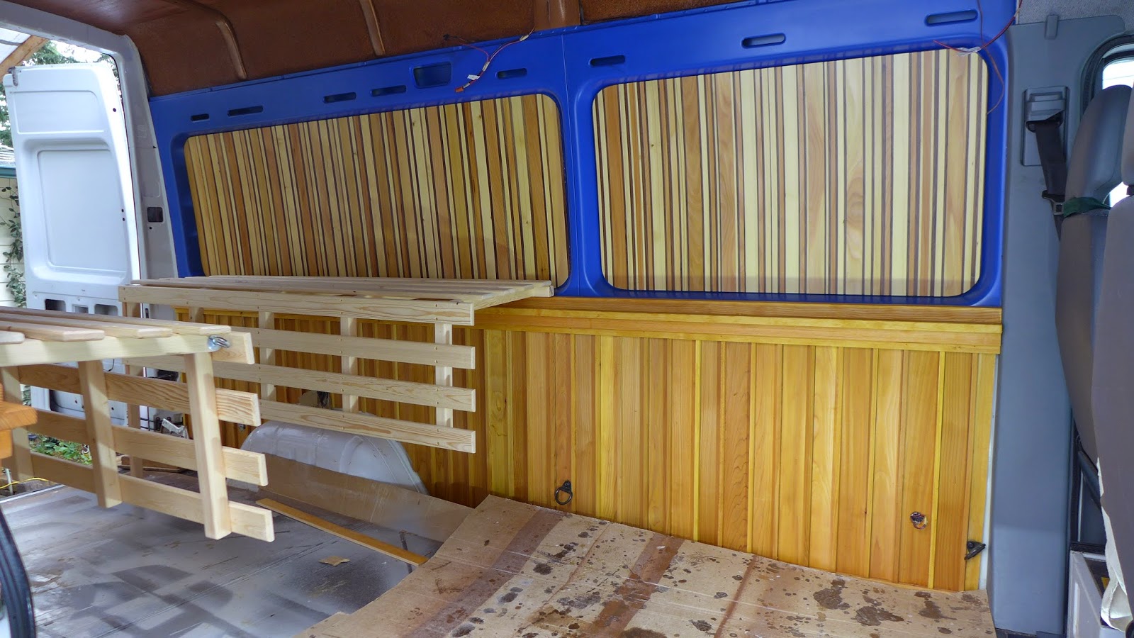

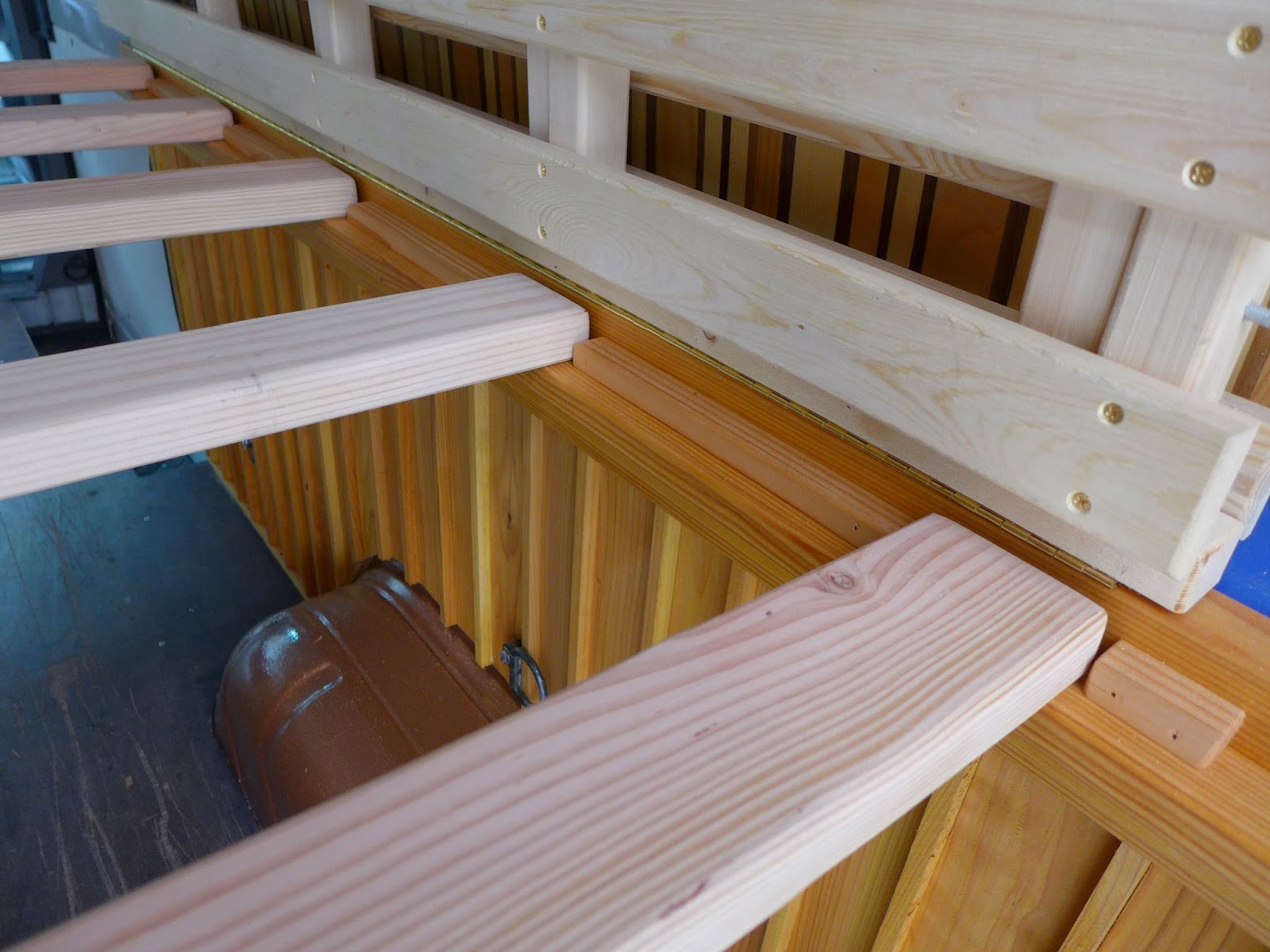

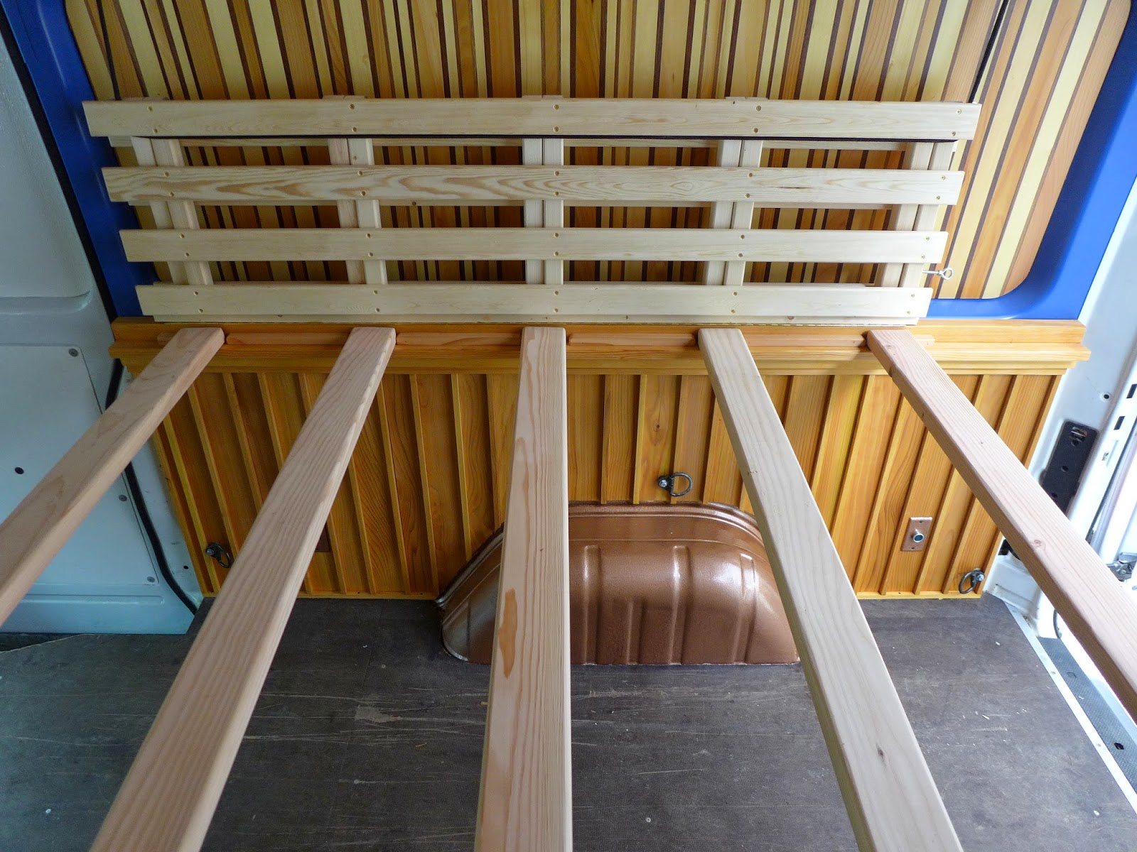

(above) Wall bed supports are 2x4's that drop onto the ledger and fit between spacer blocks...

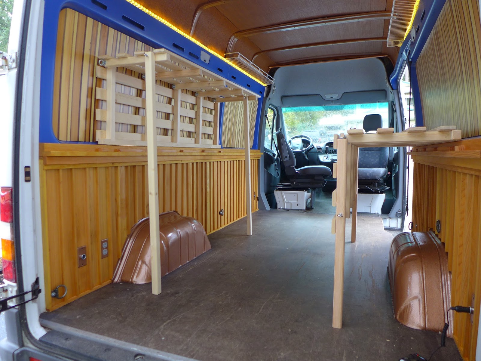

(above) The bed platform set-up takes a couple minutes...
(above) With some 2x2 vertical supports, the bed platform can be used as shelving or work tables... Keeping the rear cabin as big as possible offers a lot of options for use... "Phase Two" will be building removeable storage cabinets that fit under the bed zone... Stay tuned...
