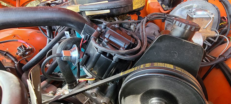

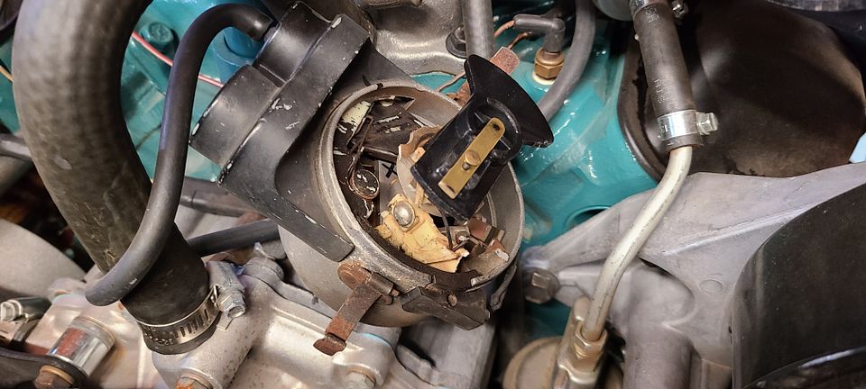

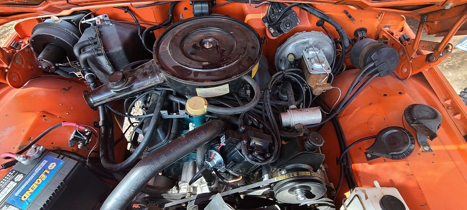

The original distributor. It blew up. Literally grenaded inside the cap. I know...many of you told me not to waste time with the original distributor, and you were right. Instead of wasting any more time with this one, I decide it was time to swap in an HEI ignition. I wanted a DUI brand HEI, but they were eight weeks out for delivery. Summit racing had their brand in stock, and at less than half the price. Guess which one I bought.

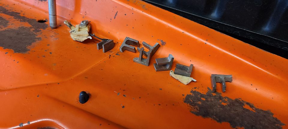

Installation was going to be a snap, until I realized that the gear on the original distributor had lost some teeth in the explosion. I fished out what I could from the timing cover, then blew the remaining bits into the oil pan, and drained the oil. Nothing came out... So as a safety measure (and instead of dropping the oil pan) I bought and installed a magnetic drain plug, which ideally, should find and grab the remaining metal shards.
If any of you have ever installed an HEI in a domestic V8, you will know that there is no one way to clock the distributor. After many minutes of searching the web for pics of an "AMC V8 HEI install", I decided to wing it. The two pinch points are the vacuum advance and the electrical connector at the pickup. Those both needed to clear things on the engine. After fitting it a couple different ways, I found many ways not to install an HEI.

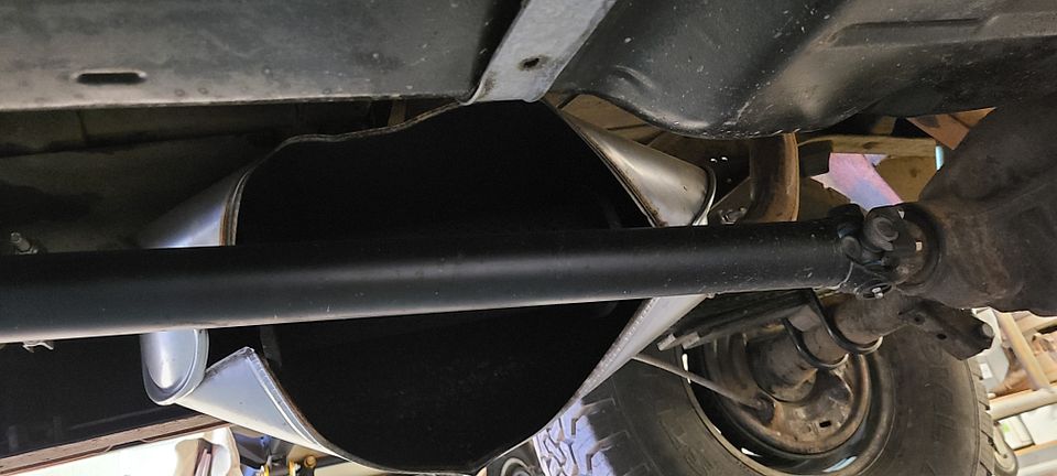

Once it was in place, I joked to my friend who was helping in the shop that day, thay we didn't know if the distributor would be spot on, or 180 degrees out. You can guess what we found out. The bang that came out of the engine was so powerful that my helper crawled out of the inside of the Jeep holding his ears, and my new shop pup was nowhere to be found. The resulting blast also blew up my brand new muffler. Bummer...
After we re-stabbed the distributor, it fired up and ran great. A timing light verified the timing to be 12 degrees advanced, and a test drive was next. Now if you had told me that an HEI would actually make more horsepower, I would not have believed you. I tell you what, it does, at least by my seat of the pants dyno. Throttle response is improved and there is no more popping from the carb under medium load. I'd call that a success.

I'm impressed with the split muffler. I'm surprised I never managed something like that. As for the hp increase with the HEI, that's what consistently running on all 8 cylinders will do for you.

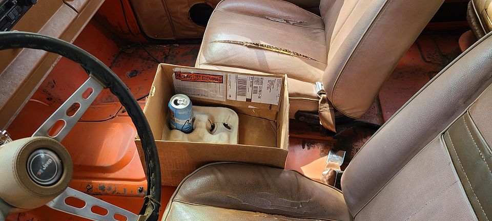

Now that you mention it, mine was very comfortable on smooth pavement kind of like riding in Grandma's old Buick. Corrugations though, not so much. I loved those seats. If they came with a decent headrest, they'd have been perfect. Kind of like sitting in a lounge chair, except mine I found after years had such severe rust on the mounting brackets it was about as safe as sitting in a lounge chair unsecured in the vehicle too.
Been there. Test drive a fresh build without bolting the seat down = something everyone should try once in their life.

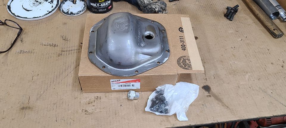

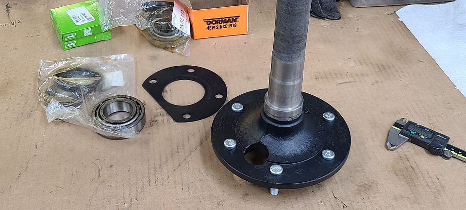

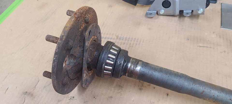

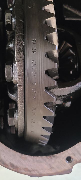

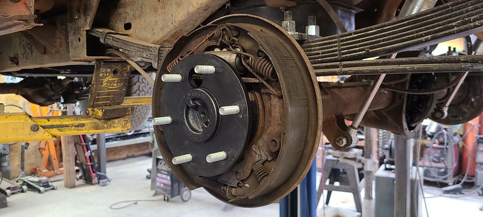

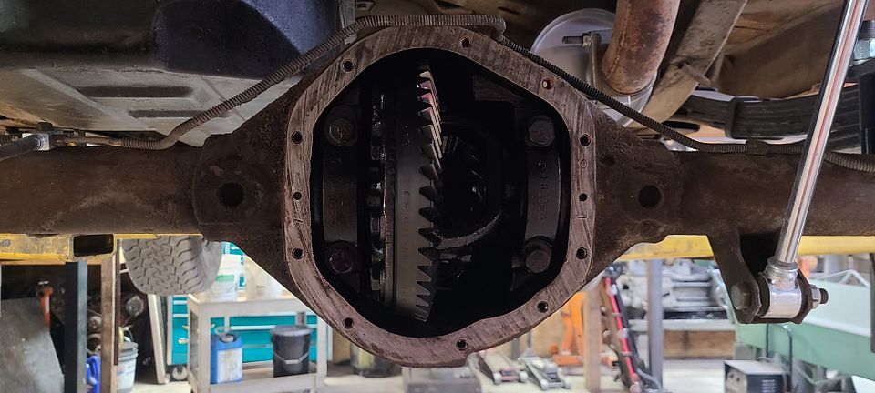

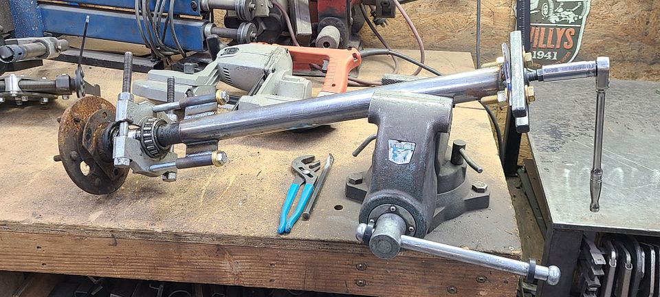

The right front axle shaft still has a broken ear, so 4wd still is not being used. Something I need to remedy soon since winter is here. Also, the right rear axle shaft had a slight bend to it, and I thought about chucking it up in the lathe to machine is straight, but I don't have enough tooling for the lathe to grab the shaft in the right spot. I elected to replace the shaft instead.

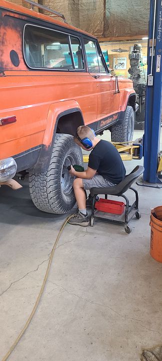

A good used shaft was sourced from JW Jeep in Antelope. New wheels bearings and a thick diff cover were sourced from West Coast Differentials. Using my slave labor, we went to work to replace the bent shaft and bearings on both axles. New studs were also installed and the diff was checked for wear while the cover was off.
