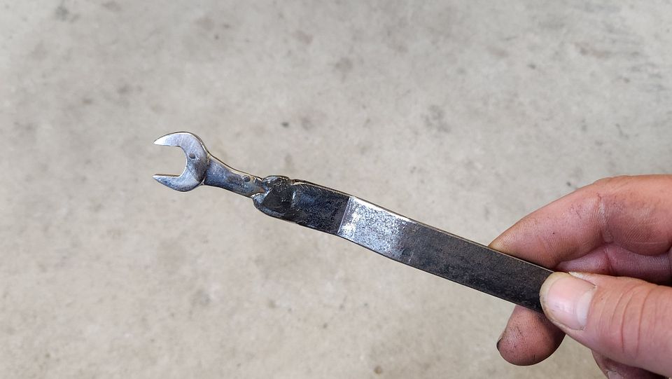

Oh, and when reassembling the spindles and hubs, I forgot to tighten the two 1/4-20 backing plate screws, so I had to make a wrench to be able to tighten them in their hiding spot behind the brake dust shields. It took more time, but I wasn't going to disassemble the hubs just to get to them.
