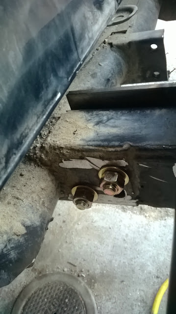

Drilled 1/2" holes in frame extensions.
Bumper brackets are 1/4" plate connected to the frame by two 1/2" grade 8 bolts per bracket.
Might add another bracket on this side to sandwich the frame.
Back of bumper is inline with rear recovery mount.

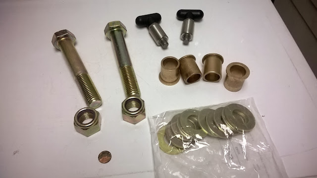

Hinge Parts From McMaster-Carr
#91257A969, 1" Dia. Bolt, 6" Length, Grade 8
#97135A038, 1" Locknut, Grade 8
#98023A038, Flat Washer, Grade 8
#6338K439 Bronze Flanged Sleeve Bearing, 1 1/4" OD, 1" ID
#91712A119 Weld-in Pull Pin

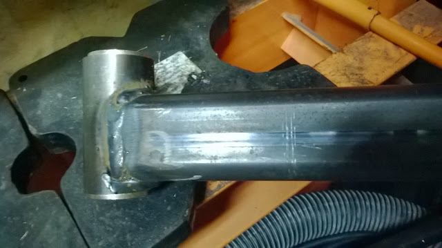

Bolts pass through DOM tubing into which bronze bushings will be pressed. DOM is 1 3/4" OD X .250 (1 1/4" ID).
Fitting the DOM to swing arm. Swing arm is 2" square tube, 1/4" thick.
Tacked
Glued

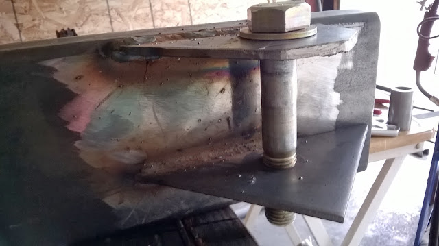

Pressing in bushings.
Hinge brackets are double shear.

Nice work. Did you sleeve those through holes in the frame? Maybe worthwhile since you're making a tire carrier. At least that's what was suggested for things like sliders. With weight of the bumper & spare, it may be needed. Not sure but I'm one who prefers to overbuild.
Might also want to run a 45 degree gusset between the back of the bumper and the attachment fin. You'll want more bearing area on that hinge line between bumper and fin, and a gusset would do it
