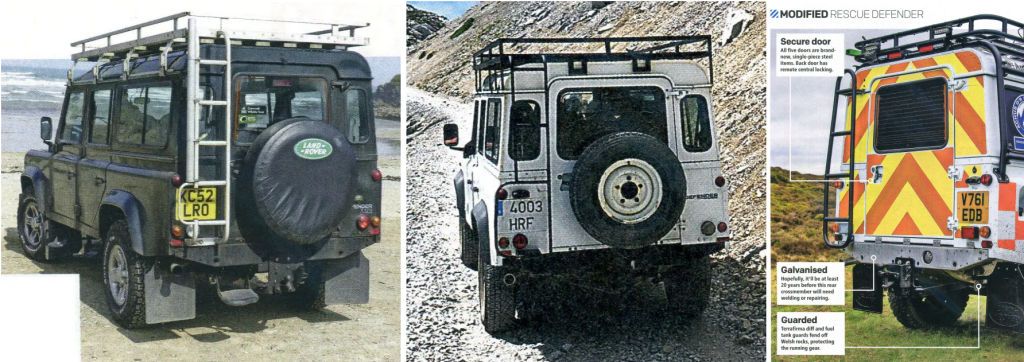

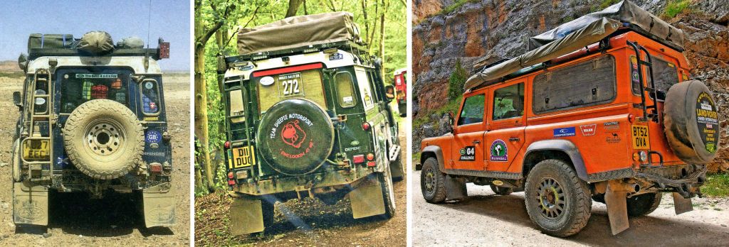

Ladders are much more common on Land Rovers than they are on Jeeps. Maybe it's because roof racks are more common on Land Rovers than they are on Jeeps?
There are lots of different ladders on the market for Land Rovers - ones that account for the license plate, ones that don't, long ones and short ones, here are six more styles:

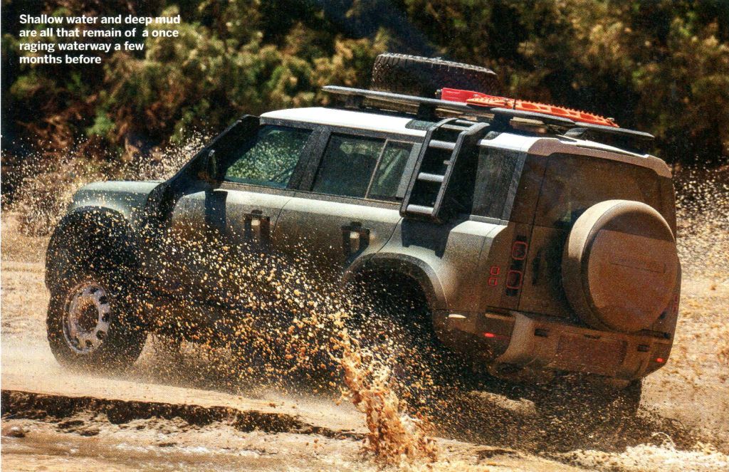

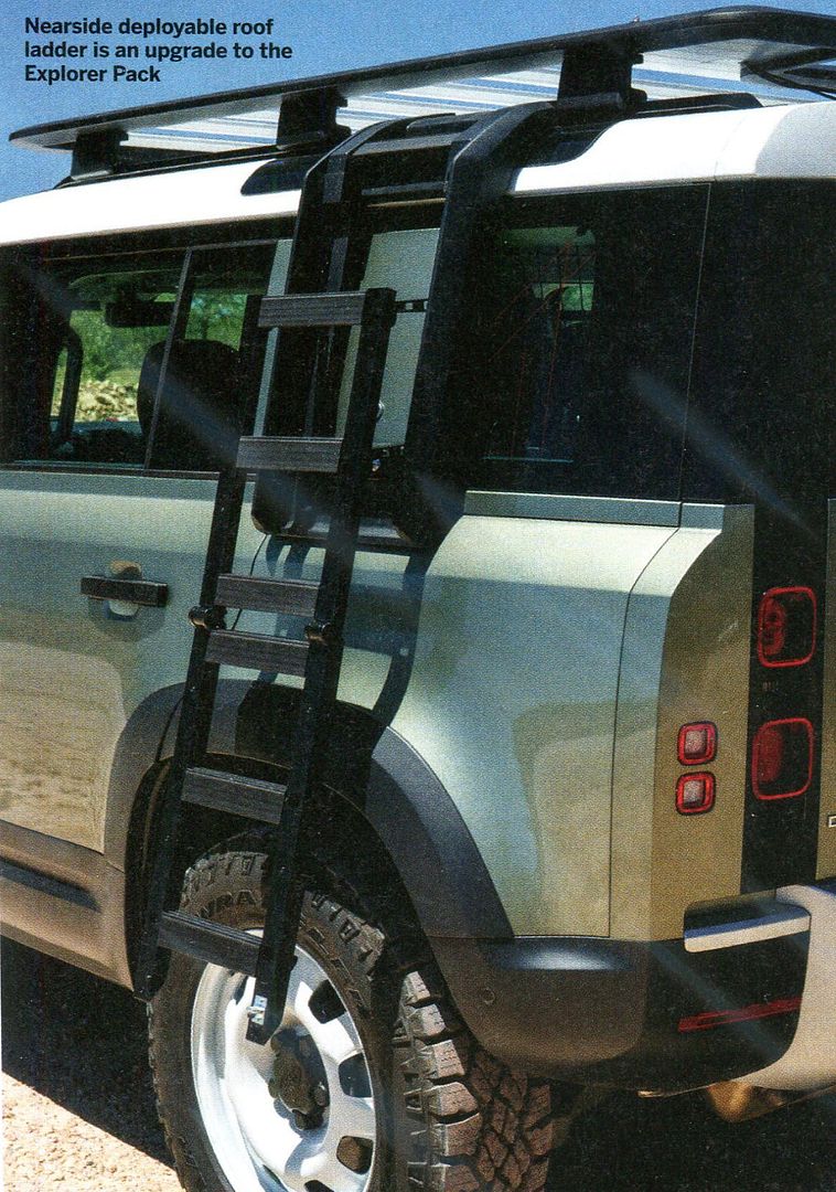

One of the factory options for the "new Defender" is called the Explorer Pack, which includes a cargo box on the outside at the left rear window (I've posted photos of this before) and a ladder on the other side:
Until I saw this next photo I thought it was a fixed ladder and that you'd have to step on the tire first to get up to the ladder. Turns out it deploys like this:

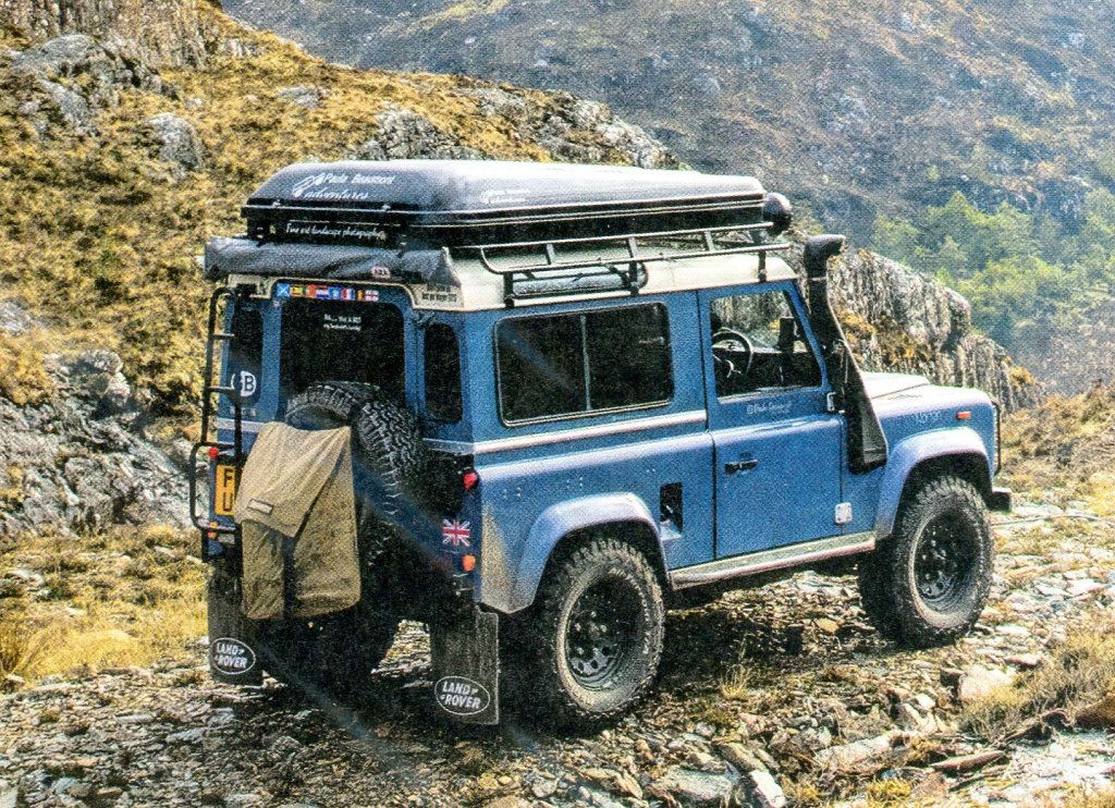

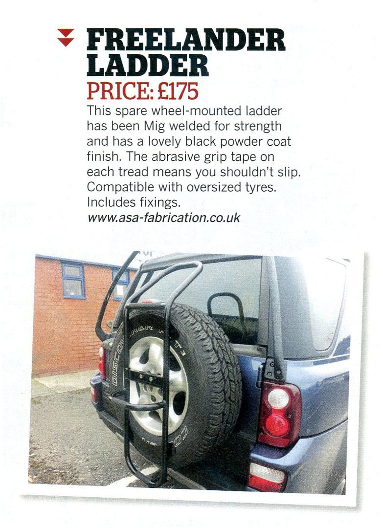

If you don't want to drill holes in your Jeep/hardtop but want a ladder, how about bolting it to your spare?

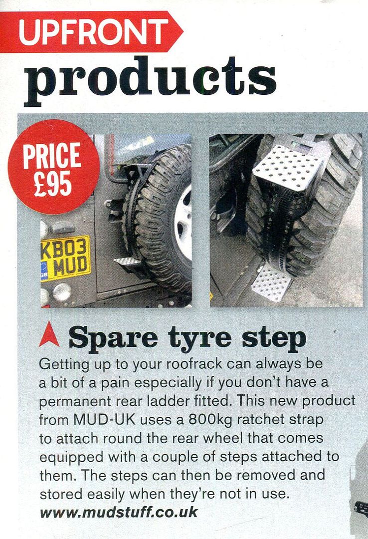

Or even simpler:
You'd have to trust your spare carrier (and tailgate if the carrier is bolted to the tailgate) in order to use one of these ideas. Probably not something you'd want to do unless you've reinforced your tailgate/spare carrier somehow.

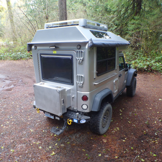

(above) Below the side window I added the stainless steel handicap grab bar... I use that for easy access to the roof rack without climbing on top... To get to the bar, the lower fold-down step is used to get to the bar height... The mounting flanges are backed with a 1/4" aluminum plate on the inside... The rear cabin is 1/2" balsa core/ glassed with 1/8 glass and resin inside and out... Solid... The 8" deep plywood rear door overhang (glassed and painted) serves as a minor rain cover for the door and a nice solid place to stand up there... In a pinch, I can tip toe along the top of the awning covers (2 sides)...

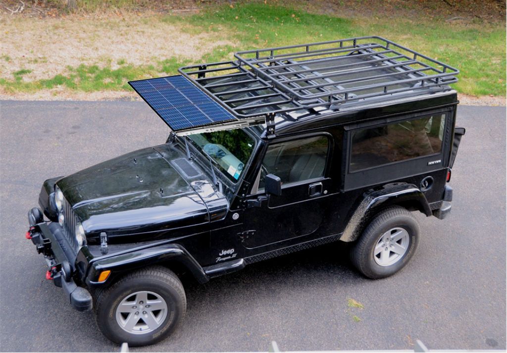

I think about a sliding mount is a great way to go, but why not have it stay on the slide instead of removing it and setting it up on the ground? I did some concept images based on my new rack extension...
Stowed, it would slide between the bottom of the rack and the roof:
Deployed, it slides out from under the rack:
It would generate power even when stowed if nothing was on the rack above it but could be pulled out when there was something on the rack.

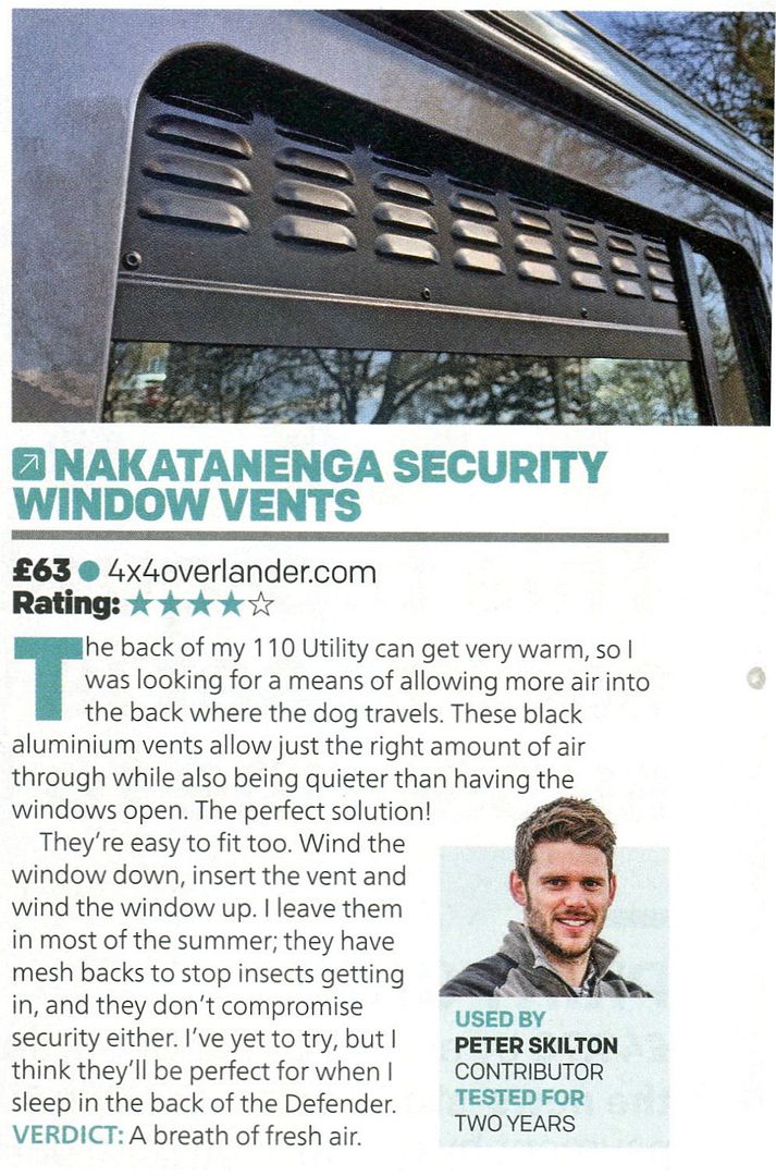

Window Vents
I think I've seen these somewhere for Wranglers but I can't remember where. Wouldn't be hard to make though. I wonder how much venting they really provide and if they do work how much cooler they would keep the inside of a closed Jeep in the hot sun.
Not sure how much cooler they will keep a jeep but they keep the back of my LR3 a bit cooler, especially with the roof vent open for circulation. Actually I use them more for ventilation at night as I sleep in the LR when I camp by myself. They have screening to keep out the bugs and louvers to keep out the rain. They are quite noisy, I mean wind noise, if left in the window area when driving. I have done that only once when I forgot, early on, that they were there.
I highly recommend them but keep in mind that they are light gage aluminum and will bend easily.DSC05348.jpg
I've built such vents for our JK by myself (aluminium rail and ABS plastic) and added a fan to bring more air into the car. We need them also for more ventilation at night when we sleep in the car without opening the roof tent.
