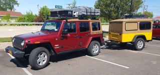

Why is it that there are no racks on Jeeps that overhang the windshield? I think they can be very useful, providing more space for storage especially when you're carrying a roof top tent. A few Land Rover examples:
A few years back I built an extension for my rack; on the LJ it overhangs the windshield a bit and the extra storage is very useful. It bolts to the front of the other rack basket and is supported in the front by the drip rails. It's optional and can be removed if only the main rack is needed.
Also, because of the downward curvature of the front of the roof, it provides a good place to mount a slide-out solar panel. The main rack, the extension and the slide-out solar panel can be used on both my LJ and my JKU, here's a photo of everything on my JKU with the solar deployed. Because the JKU is longer than the LJ, the rack extension doesn't extend over the windshield...
I always wonder why there aren't any over-the-windshield racks available in the Jeep world.b
I find the extra space very useful when I have the RTT on top. In this LJ photo I've got a plastic bin mounted on the rack extension and I store lightweight items in the box.
