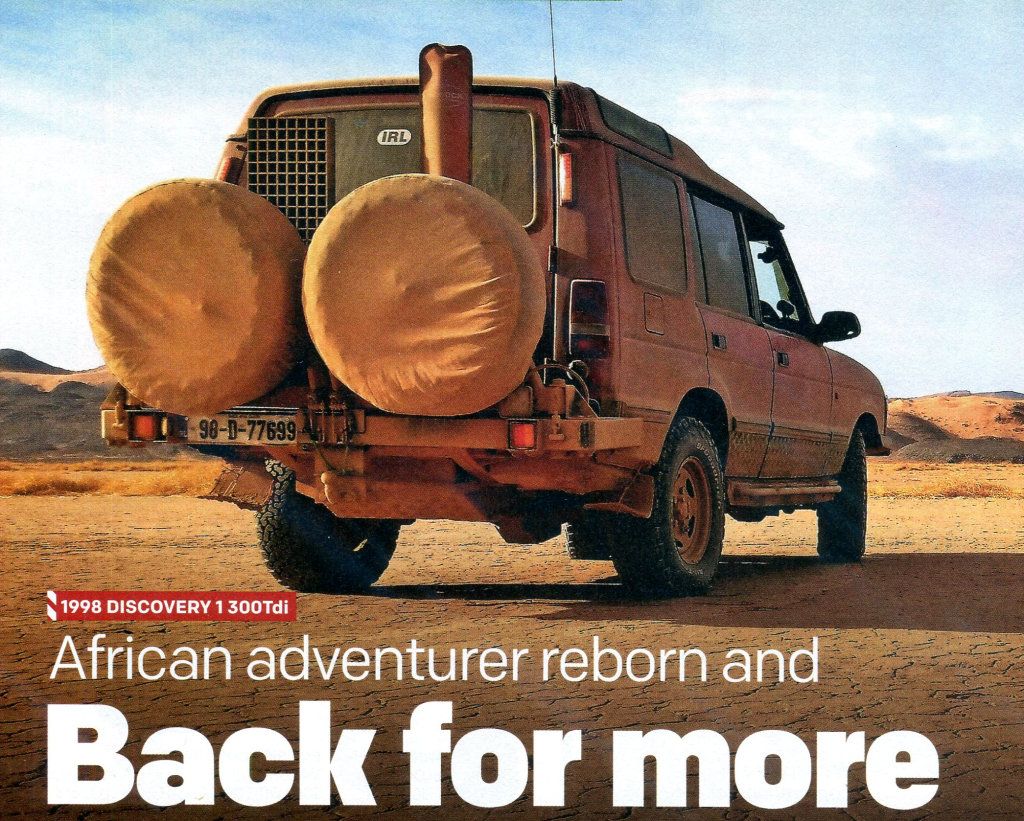

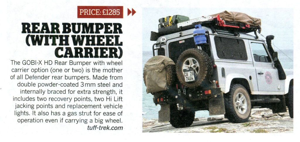

I posted these earlier in the thread, so I guess we can call the double gate idea a Land Rover idea. They both show two spares, but I've seen them with a spare on one side and jerry cans on the other.
Seems like it would be awkward to get into the cargo area with something like this on a Wrangler - you'd have to swing both spares aside, then swing the tailgate aside, then the liftgate. My preference is one operation with a barn door and a tailgate reinforcement that can carry the spare plus a jerry can or propane tank and everything opens in one operation.
