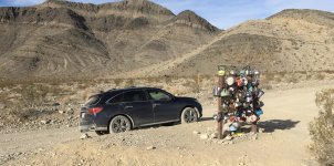

In 2017 I made a trip to Death Valley.
My daughter had listened to my Dad talk about the race track and the time we forgot the family dog when we left (only made it a mile or two before he figured it out), so she wanted to go there.
At the time I was driving an Acura MDX as my company car so that is what we took.
I read in a review that said they use that road as a test for the 'off road' part of there vehicle testing.
This was during the Christmas break so there was a lot of people in the area, they kept looking at me like I was crazy.
On the way out there was a guy with a Nissan pickup that had two flat tires, I stopped to see if I could help (this guys tires where past there 'take it to Death Valley' date)
There was another guy that stopped with a well kitted Chevy Avalanche.
He swaped one of the tires out with this Nissan's spare while I plugged the other and inflated it.
The whole time this guy is playing 20 questions with me trying to figure out why some idiot with an MDX in Death Valley had the stuff to plug and inflate a tire.
The MDX at Teakettle Junction.
