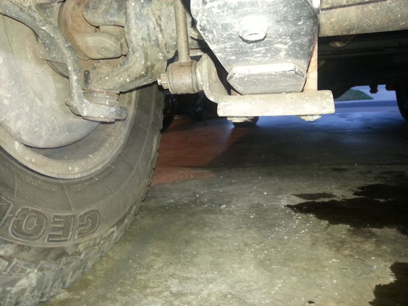

Also, I cut back my u-bolt ends for more clearance.
Before:
After:
Thanks Lecoq! Now I want to go back out and see the how the Waggy does without those rock hangers on there.
