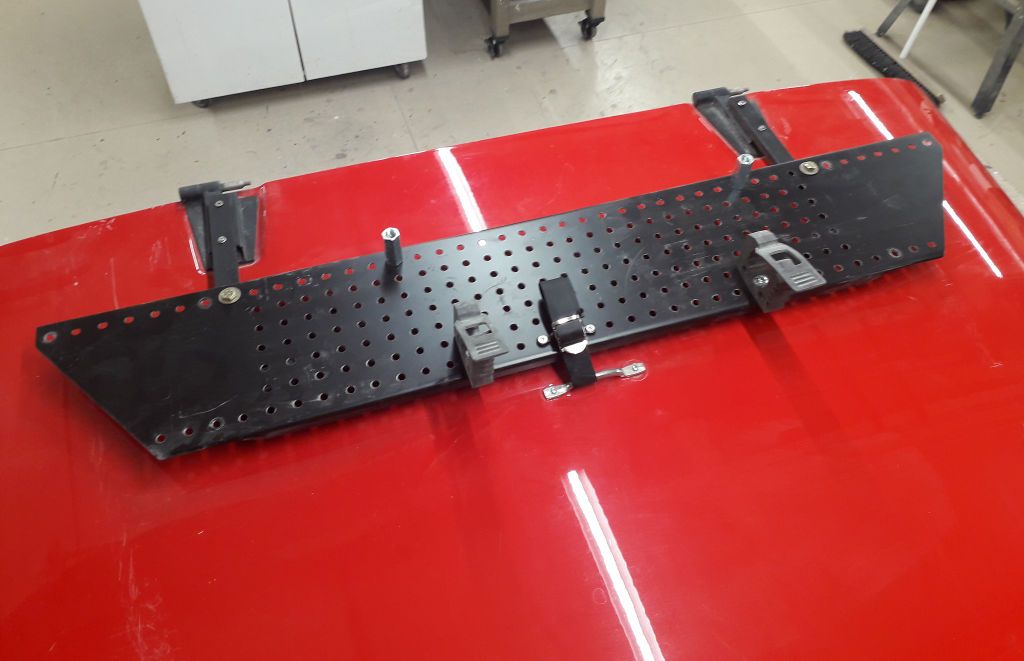

Recently I did a mockup of a gear mounting panel for the hood; the panel in these photos is from a prototype of something else I did a few years ago so it's not exactly the size I would make one of these for use on a real Jeep
I mounted the panel to the hood hinges and the front of it is supported by the windshield bumpers and secured with the windshield footman loop. The hood hinges aren't factory JK hinges, they're HD hinges which are designed to enable things to be mounted to them, so this panel can be installed without disturbing the bolts securing the hinges to the hood. And it can be removed in minutes, making it perfect for installation only when needed for an expedition.

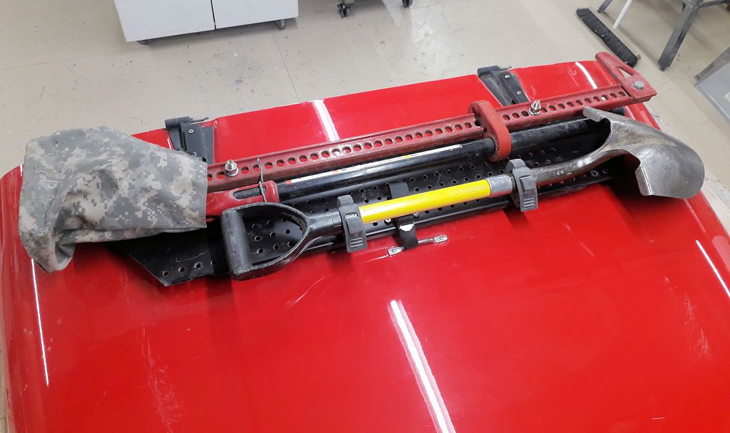

In the photo above the grid has mounting studs for a Hilift on the panel and a pair of Quickfist clamps to hold a shovel.

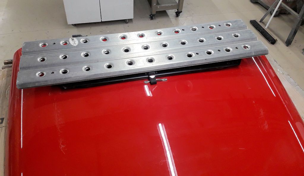

Bit it would also be great for MaxTrax or for aluminum sand ladders (they're just setting on the panel in this photo, they're not bolted down):
The above photos are just a mockup using a panel I had on hand, if I were to make one of these for real use, I'd make it larger as shown by the dashed line in this next photo but I did this mockup just as quick proof of concept starter so I used a panel I had on hand instead of making a larger one just for this mockup.
