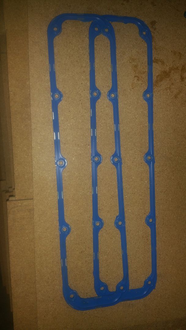

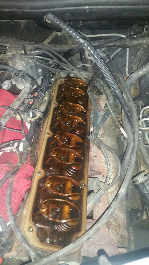

Then valve covers came off...out of the 20 or so bolts, about 10 of them I could unscrew by finger...probably a source of my leak?

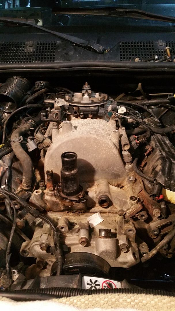

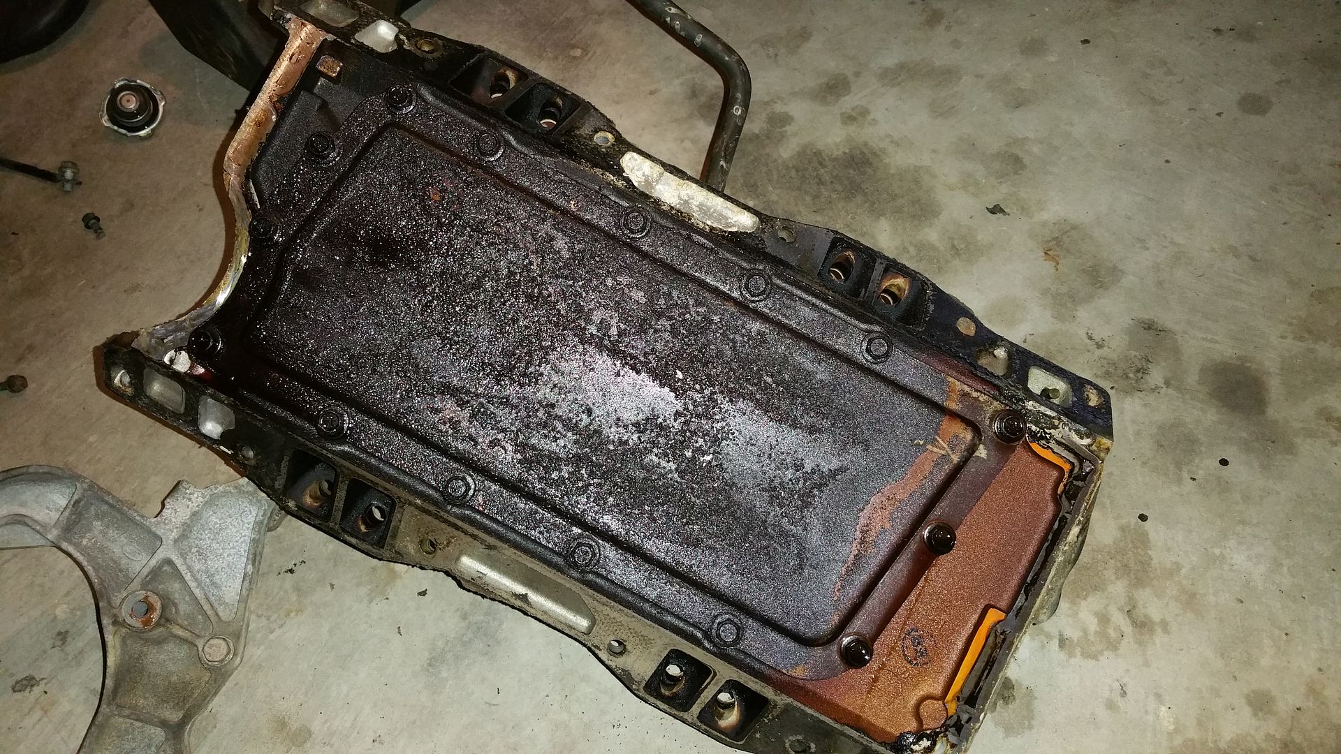

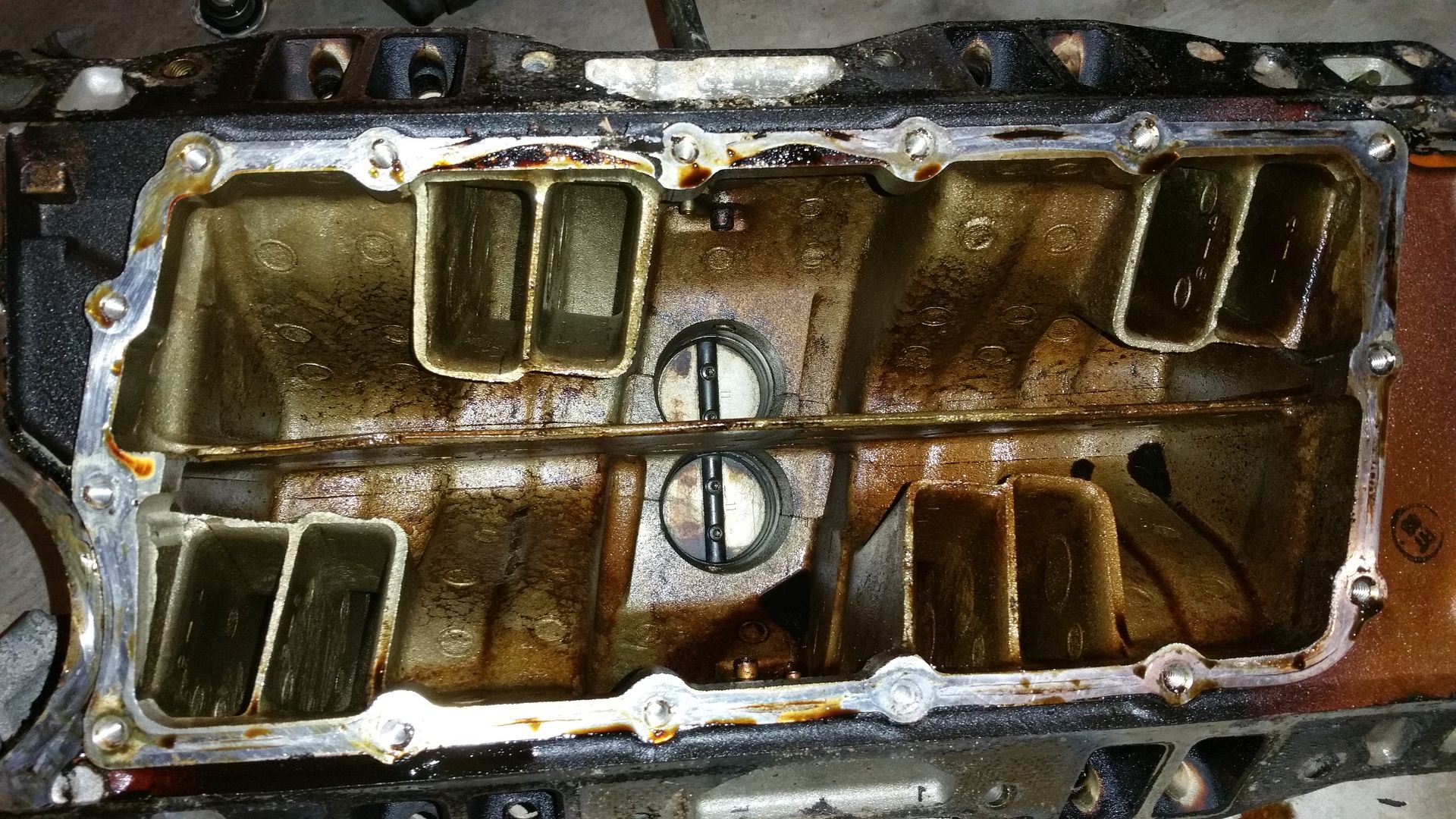

Then I looked on to the intake manifold...

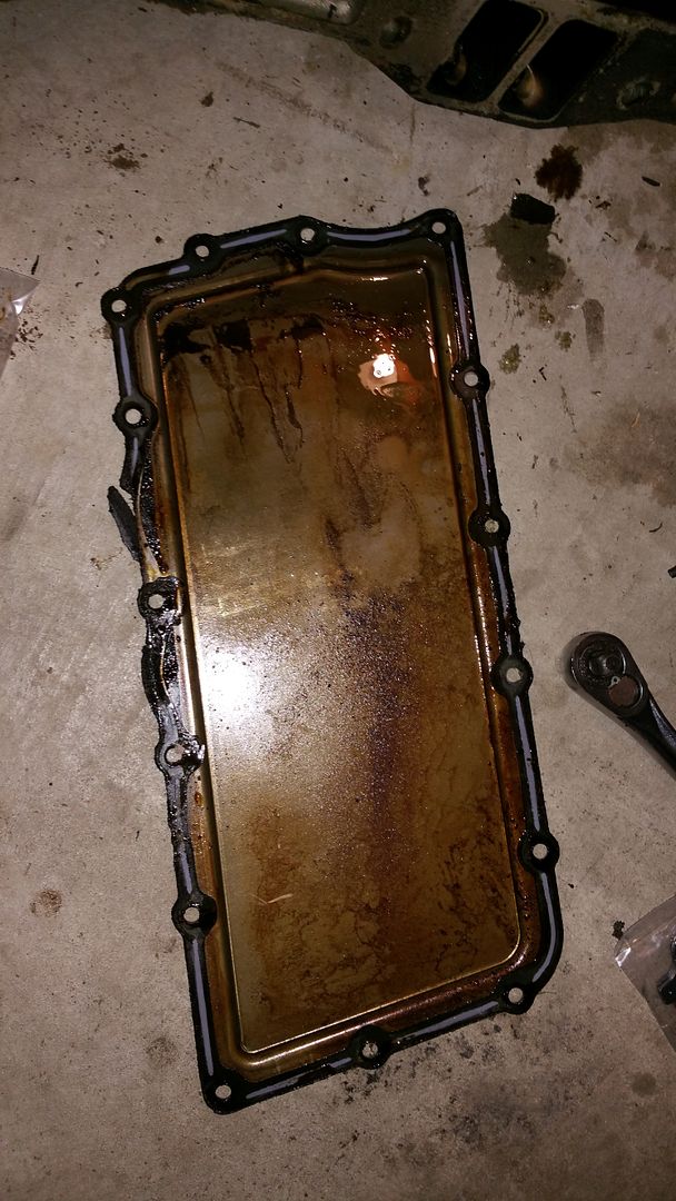

Intake plate taken off, this should be clean as can be...notice the busted seal on the upper left side
Also should be clean

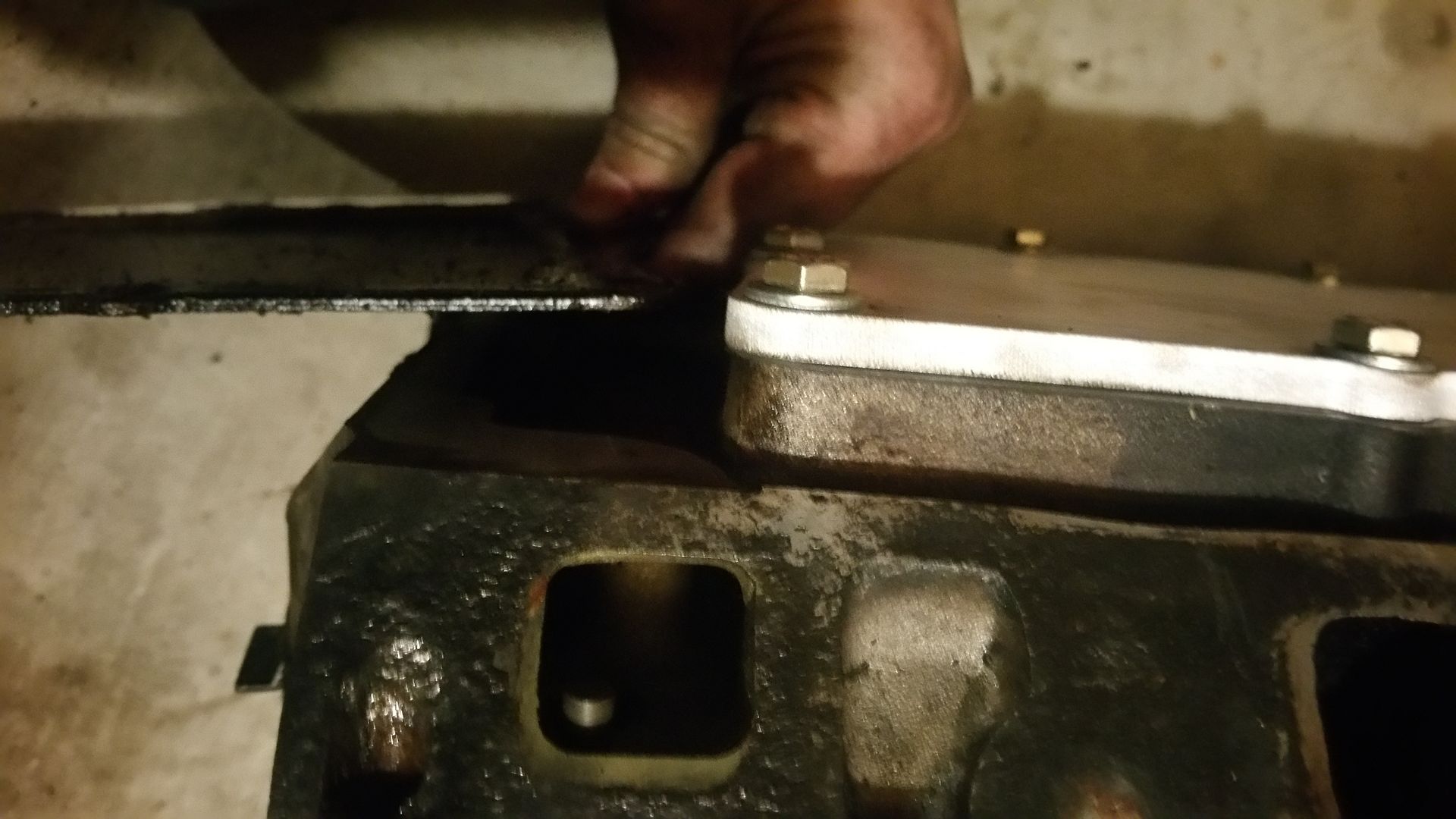

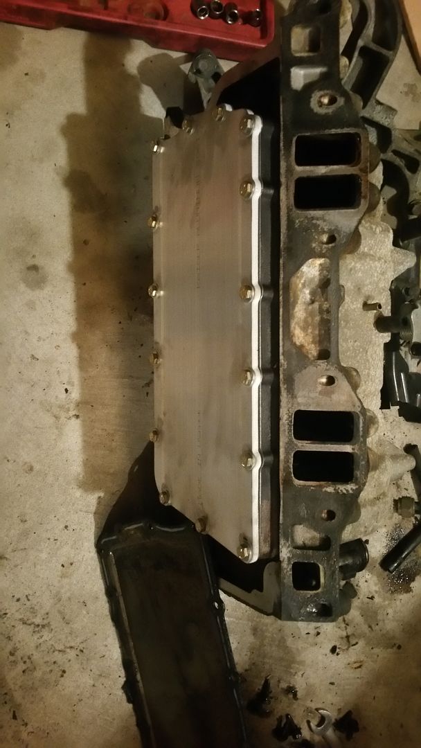

Cleaned and new "fix" plate on
Factory vs. "Fix" width

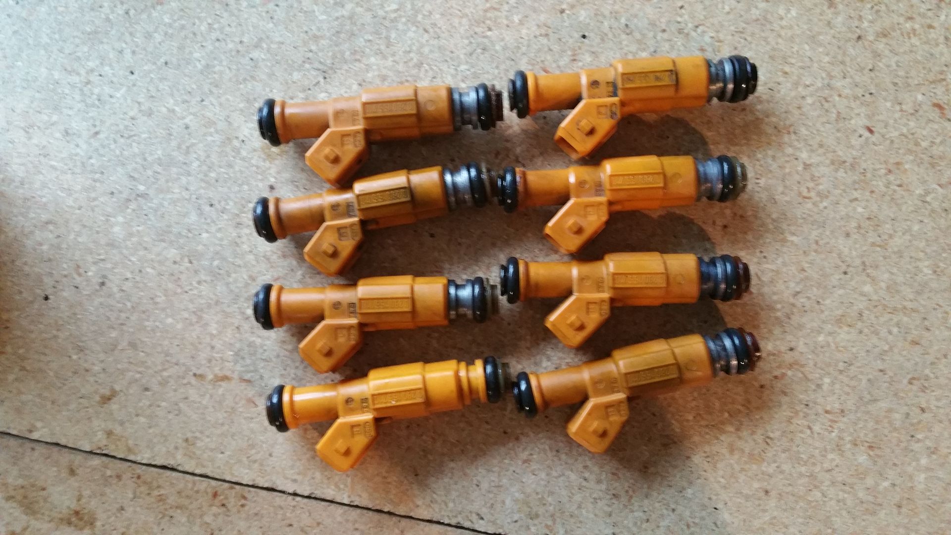

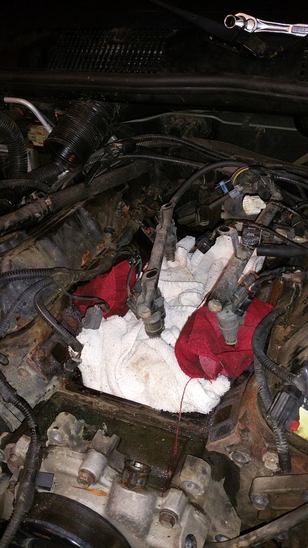

then I put in the new injectors...
By that time is had been awhile. I spent some time cleaning stuff up, and ended up around 12:30AM putting stuff back together...the front and rear gaskets suck trying to get them to stay in place, but I finally got it....when I went to torque the new bolts on the manifold, I must have had a bad torque wrench...I should have used common sense, the wrench wasn't clicking, but felt over tight...I ended up snapping one of them (good thing I have an extra) and had to take the manifold back off and the broken bolt easily turned out. I decided to stop for the night and continue today...work is hard when you're tired!

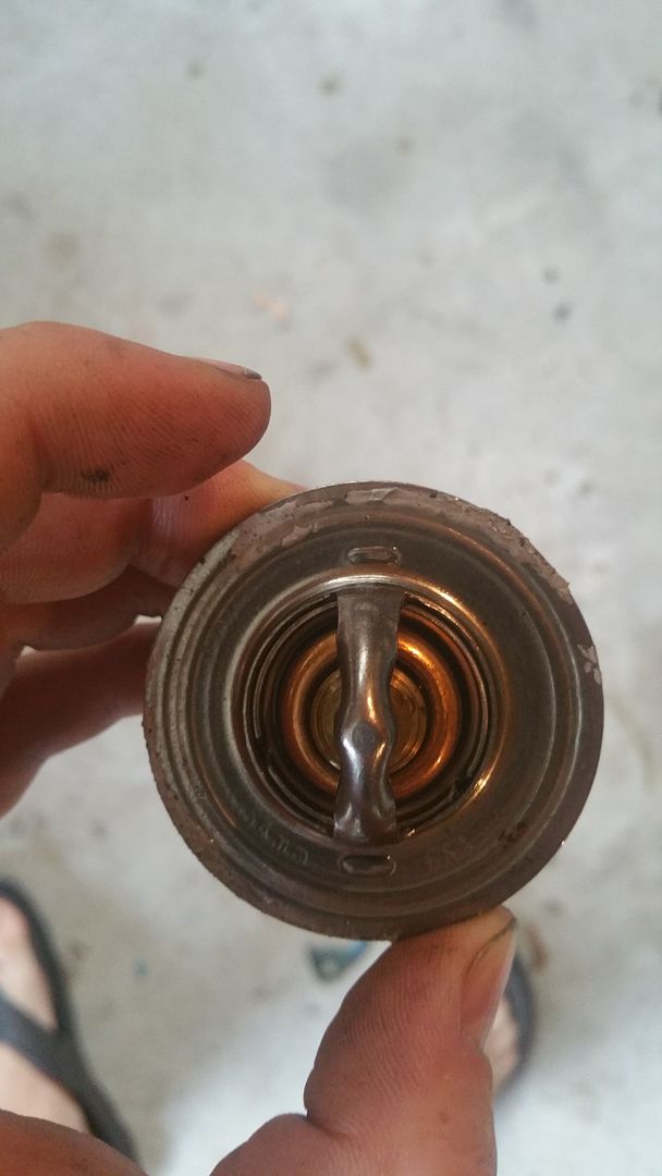

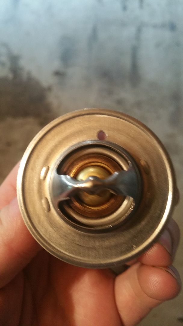

Finally got everything back together, but had an issue. I managed to get air into the cooling system, and the temp sending unit wasn't working. I drained all the coolant I could (including the plug on each side of the block) and plan to finish up today. I even drilled a hole in the thermostat as suggested by many since the after market thermostats don't have the factory passage to let air through in case of a situation like this.
Old (aftermarket)
New, same as old, but drilled a hole in the new one... (aftermarket)

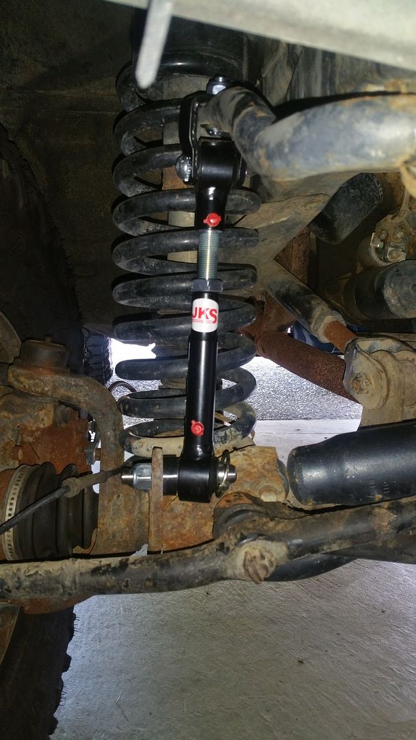

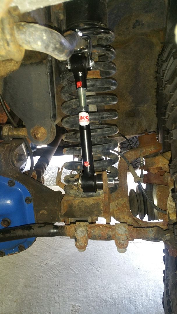

Installed the JKS Quicker Disconnects. I LOVE THEM already. So easy. and, as I thought, my sway bar was under a lot of stress because the end links were too short. Jeep rides a lot better now. I didn't have the nylock-nuts suggested for use with the "tie-ups" so I have to run to the store and get those for when they are disconnected, but the hole has been drilled in the skid plate at everything. Shortly after the disconnects were done, I did the sway bar bushings, which helped a lot as well.
