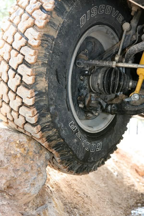

Cooper ST @ 15-PSI
I went 'wheelin this afternoon for a short trip, just a few miles and near home. Had the Cooper STs on the Mall Crawler and dumped them down to 15-psi like I usually do all my 255/85.
SOAZ is correct, the STs are much softer (nice ride :-) and 15-psi is very low for them. 15-psi is great on my Maxxis Bighorns or even BFGs. My car weighs 5,500-lbs.
They did grip well and deformed spectacularly if I had lots of pressure/weight on them. Deformed normally if they weren't being stuffed into something. It wasn't child abuse but it was 'tire abuse' :-)
Edit:
Tires were about 34-psi warm, and dropped to 15-psi warm.
I didn't air them back up until this morning when they read: 14.5, 14, 13.5, and 13 in my garage :-)

Dang Redline, I can tell you right now that if I ever aired those tires down that much on some of these rough "roads", I would shred the sidewalls. The rocks here are often really sharp, jagged, gypsum/calcite/limestone broken up by the bulldozer that scraped the "road" out of the brush.
That said, I'm still undecided.... If I was driving roads like the one pictured in my original post every day, it would be a no-brainer. The catch is the tires have to do double-duty - rough rock roads on one extreme and my wife driving my two little boys on 300 mile highway trips on the other. I've gathered a LOT of info on the net, and it pretty much boils down to all the posts I've read that BFG KM's are "not so bad on the highway", vs. Cooper S/T's are "not so bad off-road".
I just have to decide which extreme I want to favor. I guess if anything, the practical side of me is leaning a little bit toward the S/T, since I figure can deal with the tires' shortcomings off-road (at 5 mph) better than I can deal with their shortcomings on the highway (at 75 mph). However, if the "not so bad on the highway" comments on the BFG KM are only related to noise and not handling, then I'd probably lean toward that tire...

It is amazing those tires bulge so much at 15 psi... Anyway, on those I would run 18-22 personally, every time I have been that low I have killed a tire.. (and of course it sucks ruining tires)... I like the Cooper SSTs quite a bit, I also have two sets of BFG ATs. I am on the former MT bandwagon too but a nice streetable MT is not a bad thing, just the noise and premature wear. I have never had a tire that stuck like glue more than a Goodyear MTR that I loved, despite the chunking. Even with the chunking, the tires still lasted/wore very well. Again I just hated the noise. I noticed no mileage losses either...
