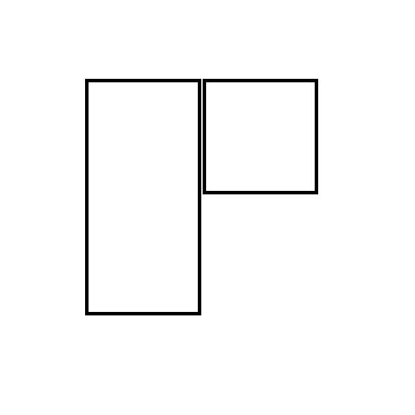

Even easier is to build the front frame out of 1x1 and the sides out of 2x1 and you will end up with a "L" in your inside corner leaving you a nice semetrical outside and two surfaces to weld/bolt to on the inside.
I dont want to seem to dense but any chance you can give me a visual? I cant seem to get how the 2" side (assuming corner too) would look semetrical to the front?
Box Rocket
Well-known member
This would be looking from the top. Use a 1x2" to make the side of the corner, and a 1x1 to form the front of the corner. From the outside it appears as 2" from both side and front and give a surface to weld/bolt to on the inside.
