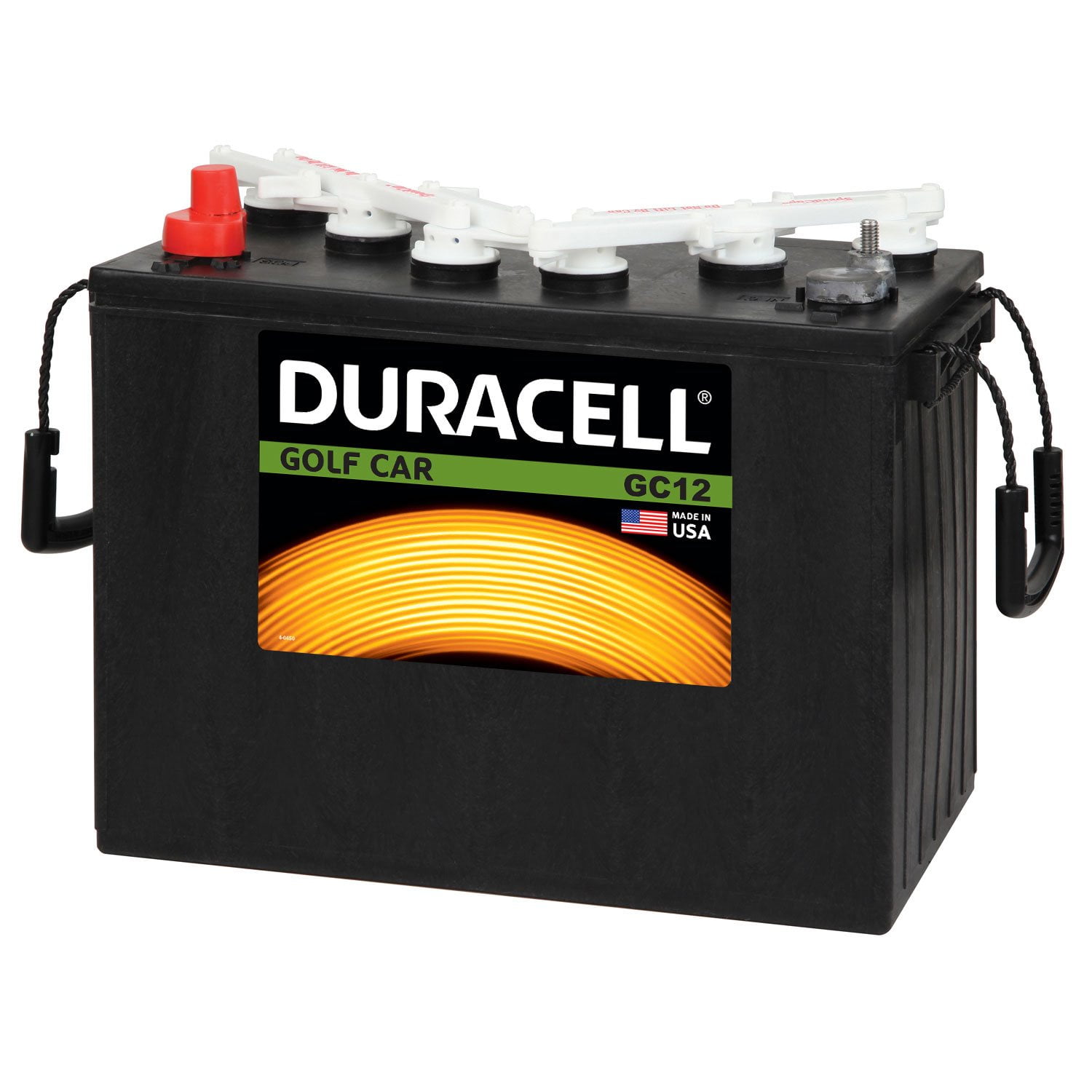

Not apples to apples, but here his the group 27 duracell pseudo deep cycle.
