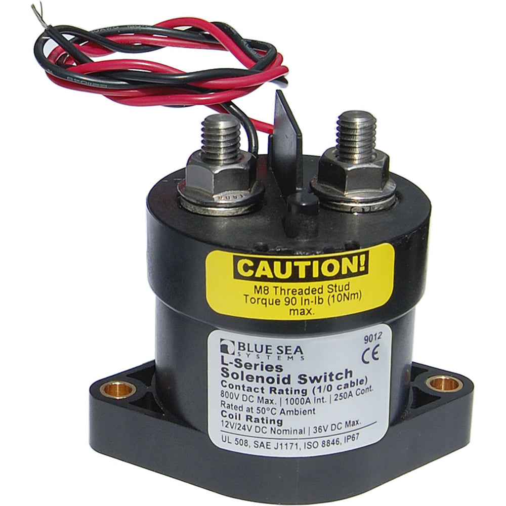

The battery combiner (Cyrix-Li- Ct). Was getting 14.1A but only letting 5A pass through at times.
I pulled it out of the system and I'm getting. FULL Juice.
I'll have to work I'm a battery protection piece in the future, other that the manual disconnect I have now, but that's good enough to roll west!
The old school way of combining two batteries with engine running and then isolating them with engine off.
Have the solenoid hooked to a fused ignition on power source that is off with the key off. No chips to fail.
