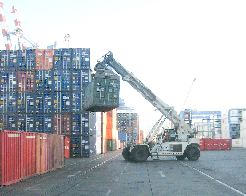

If you for even one millisecond are considering not securing your vehicle inside the container I urge you walk/hitchhike/bicycle/drive/etc. to the nearest working port.
Finagle a tour or bring good binoculars or a telescope and watch the giant pickers move the 80,000 lb. / 36,287 kg - 40 ft / 12.2 m containers around the docks like children's play blocks. The rate of acceleration and deceleration is incredible, to say nothing of the drops that precede the very loud booms you will hear.

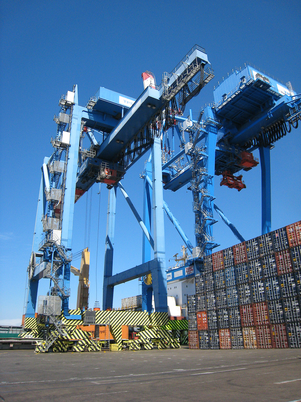

If it is a large port get an angle on the massive dual rail cranes that unload the container ships. Count how many seconds it takes to cycle that crane, from lock on the container on the ship to unlock on the 100' to 200' high stack of containers on the dock. Do a little mental math and consider the G forces applied to the container and its contents in order to accellerate and decellerate the load to achieve that time.
I guarantee that after viewing this for a few minutes to hours (if you are as hypnotized by it as much as I am) you will be crafting tie down strategies all the way home.
Picker used to move containers around on the docks. You cannot believe how easily they toss around the 80k lb / 40 ft load.
High speed crane used to load/unload containers from ships.
