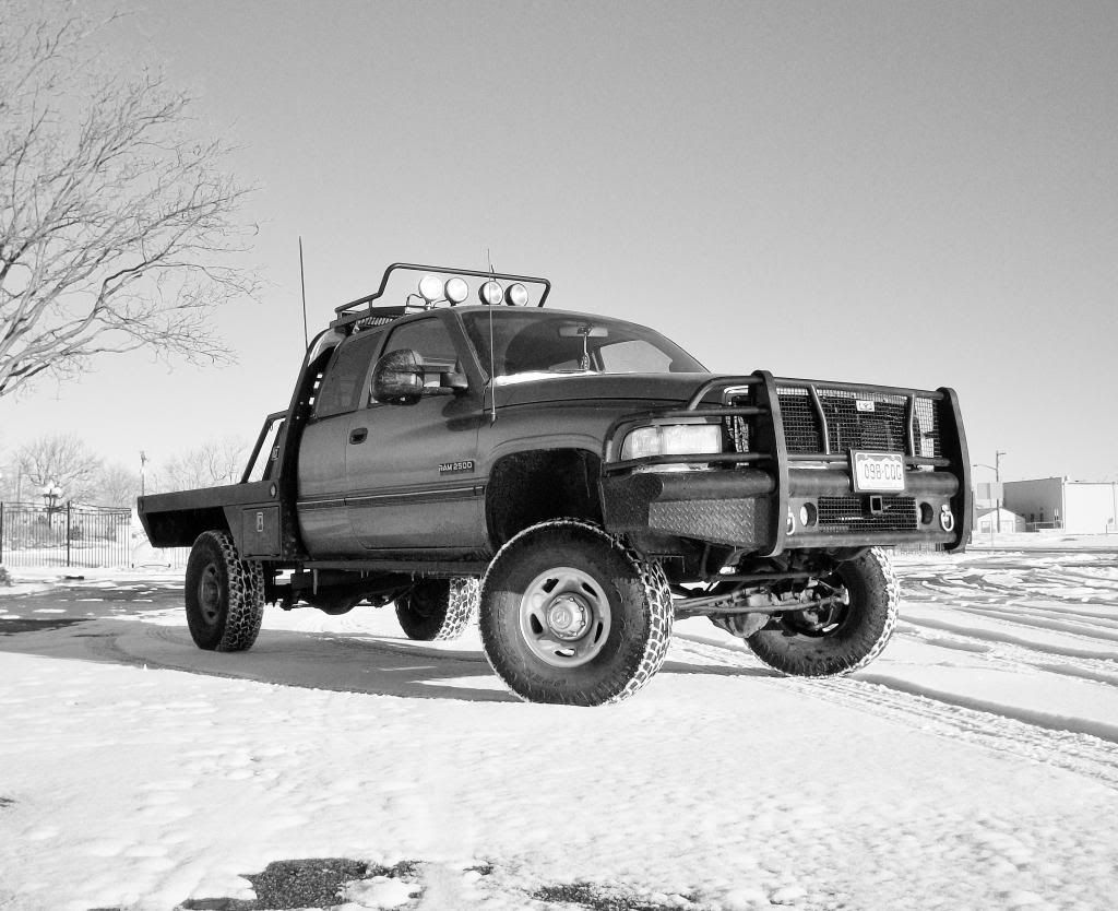

Got Some New Shoes!

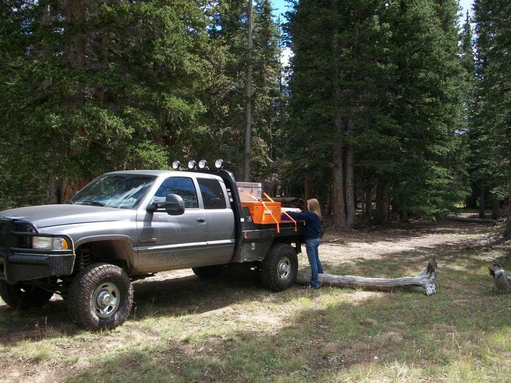

Hey folks!

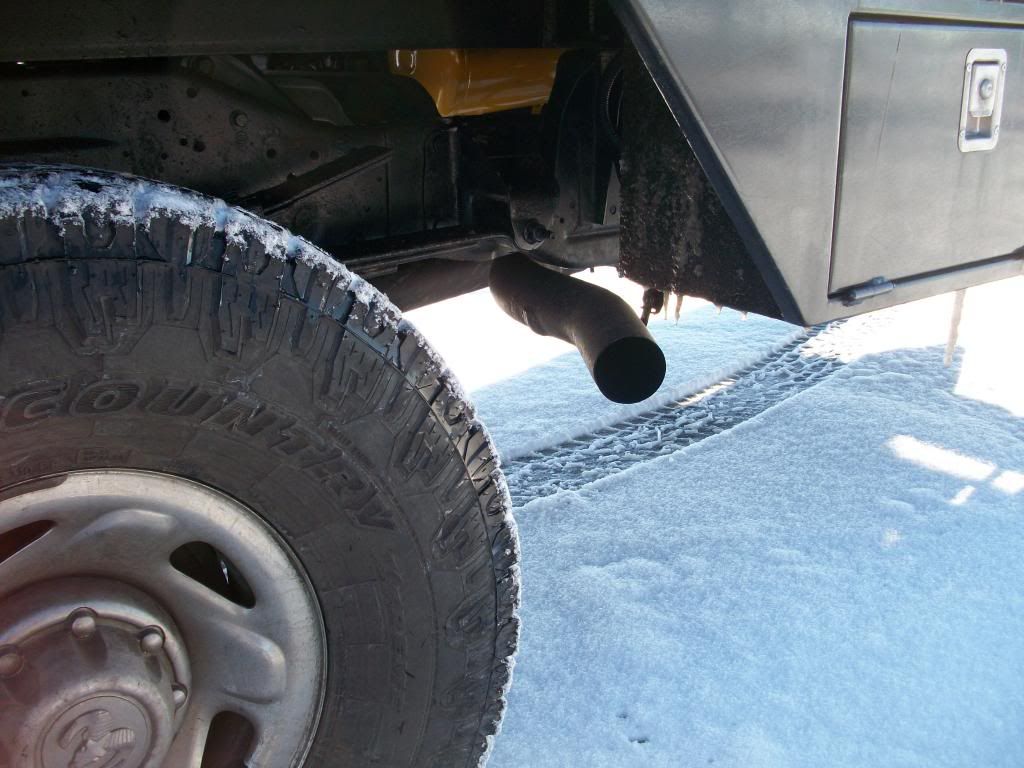

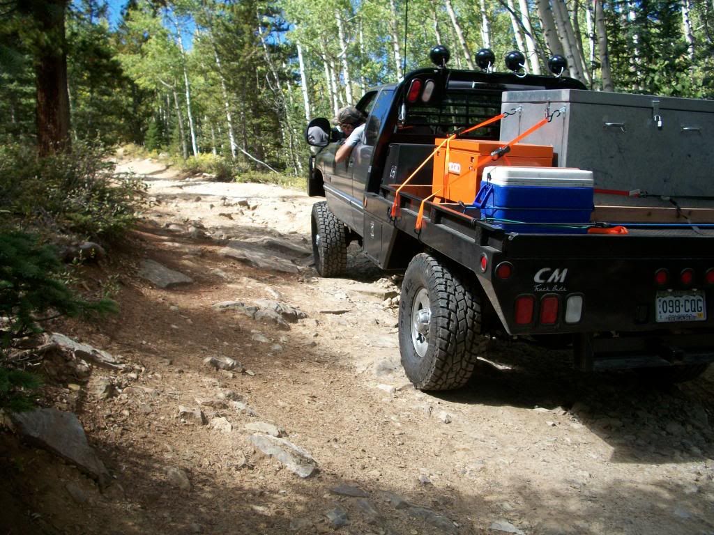

After lusting after some sort of mud terrain for years and years, I'm happy to say I finally own a set! I wanted Mud Grapplers, but I also wanted to be able to drive more than 20 minutes without getting a headache from the roar. I decided on some 37x13.50 Cooper STT Pros, and MAN am I impressed. For an open lug knobby tire, these things are amazing on the highway. Highly recommend. Also had to get some new wheels, since a 315/75 is the biggest practical size for a 16" wheel, unless you jump to a 385/70, and that's a bit too big for this application haha. Now the big rig's rolling on 18x10 Moto Metal 970s with -24 offset, pretty much perfect. Got about 600 miles on the new set, and have only 2 problems to report: I can get the passenger front to rub the inner fender and full right lock if I hit a big bump, stuff like speed bumps and curbs seem to be the exception; the second problem is my speedo is off 12 mph at 80, and therefore my odometer is way off. Guess I'll be checking my mileage with google maps from now on haha! But I'm doing almost 400 less RPMs to go 80 so who knows, maybe my mileage will improve! I doubt it, but I'm an optimist...
I'd also like to give a shout out to Toyo. I got somewhere in the range of 50,000-53,000 miles (can't remember exactly when they were put on) out of my Open Country IIs. For an all-terrain on an 8,000 lbs truck, I'm very pleased. But they were balder than drag slicks...
Also, flash9588 and t.Sparks, thanks for stopping by! I'm sorry to say I'm not working on the camper anymore (see post #115, pg 12 I think?). "Life" kind of happened and I have been moving around so much for work that I just couldn't justify keeping it. I ended up cutting it up and selling several parts off of it. I still have 90% of the steel and aluminum that I plan to use to build a skid for my welders one day (and use the remote jacks to make it removable without a forklift!) once life settles down... and I just added to the chaos, because the little blonde passenger seat cover and I are engaged as of January 1st!
So we're going to be busy for a while, but I'll be in touch.
Happy 2017 everyone! Hope the new year brings many adventures and fun memories, and few broken parts haha!
Take it easy,
Graham
