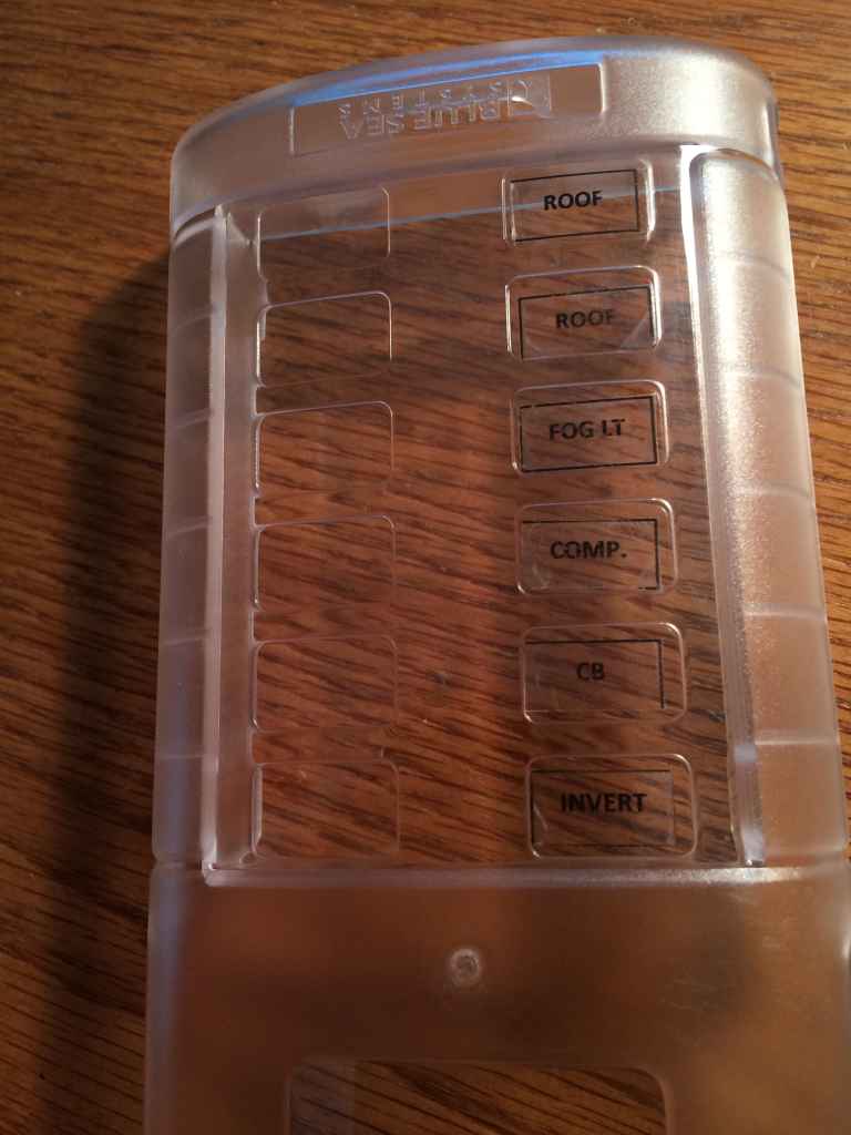

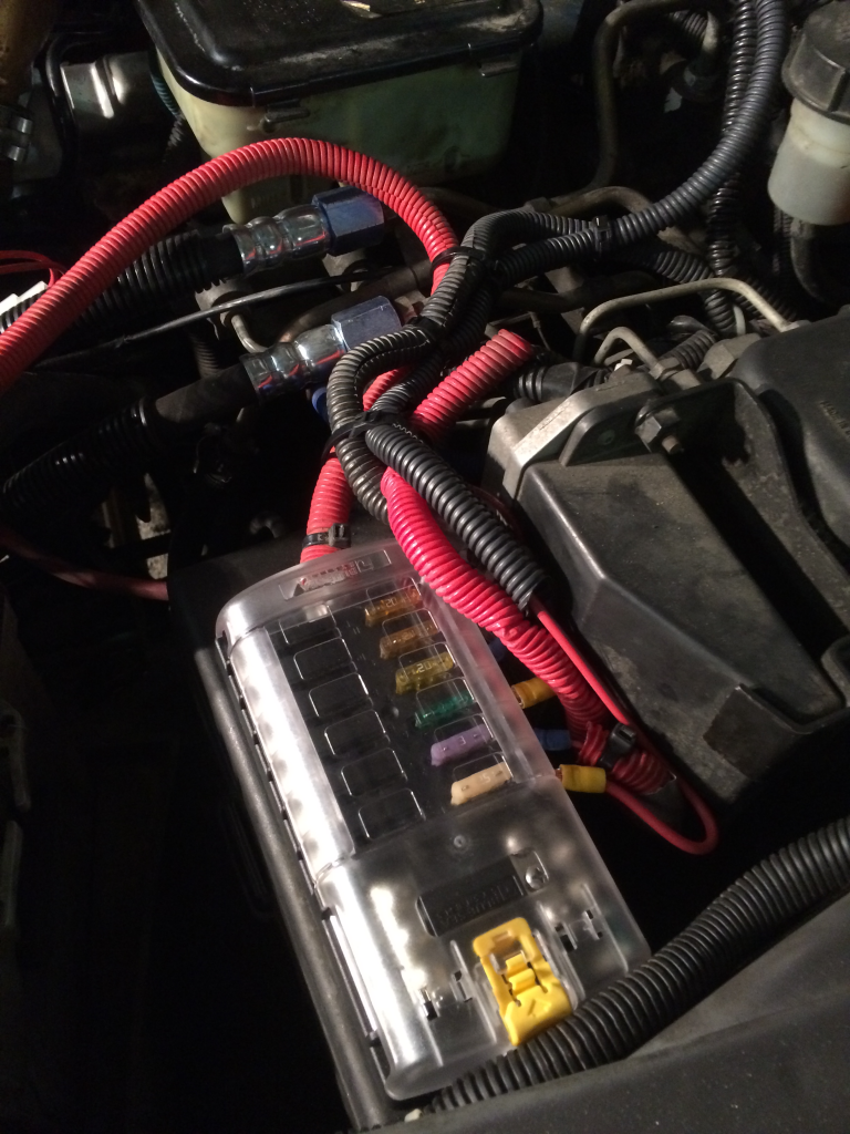

Some of you may recall, back at the very first page of this thread, when I installed a pretty cheezy fuse block for my aftermarket stuff. Well, after over a year of kicking around the idea of it, I'm finally a member of the Blue Sea club.
I also got crafty with that window inkjet paper I use to make my service stickers and made up some simple labels for the new fuse block. Now I don't have to remember which are the roof lights just by the fuse they use hahaha!

Question regarding mount of the blue sea, as I have one too but have balked on mounting. Looks like you attached to cover of the fuse/relay box?
Show and tell? My thought was actually the same, use some sticky adhesive for velcro...

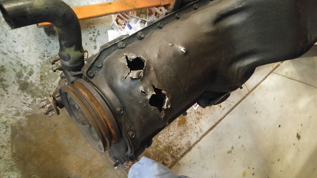

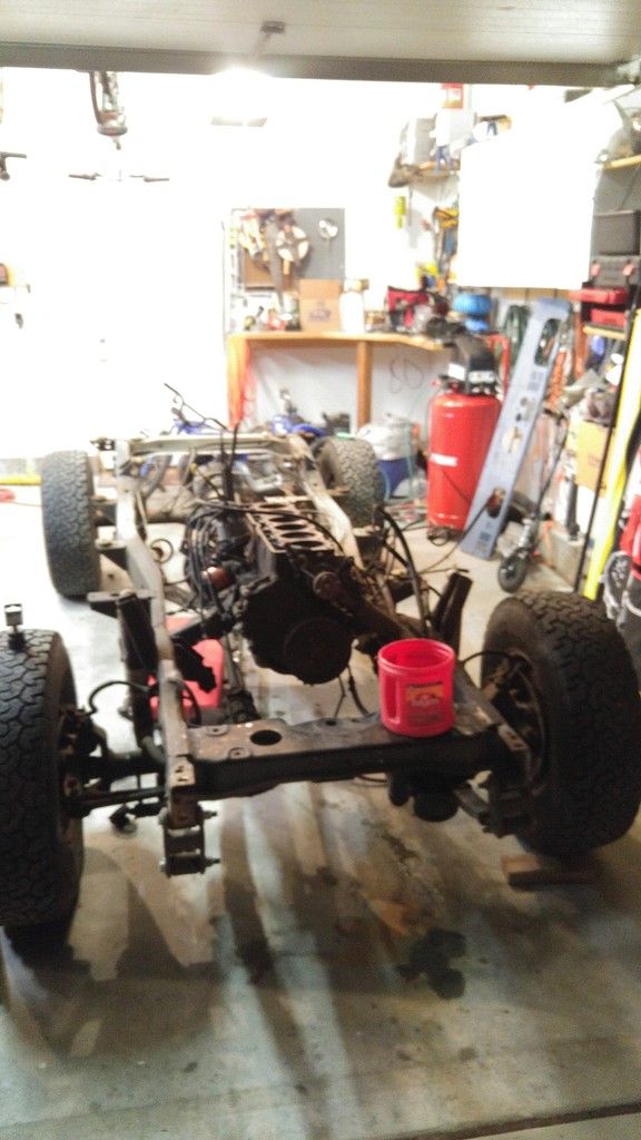

Switching gears, here's a few more you might enjoy. I'm helping my uncle with a 1984 CJ 7 project he just started. He picked it up with a blown 4.2 (previous owner hydrolocked and broke #1). I helped him get the tub off and drivetrain out last week, so this is out little side project together.

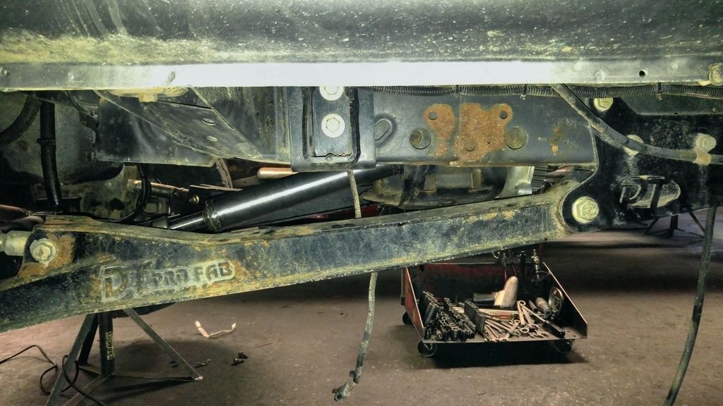

So this is how my front driveshaft sits in relation to the radius arms. In my opinion, this is still pretty steep for the torque this thing puts down, but the only way to combat this would be to have the transfer case further back and have a high pinion front end, I'd think. I guess that'll be the plan for the future?

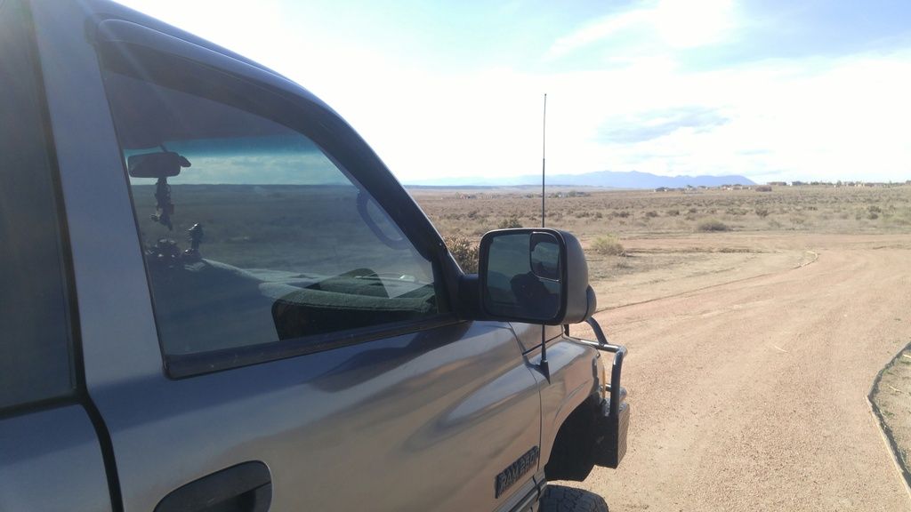

OK what else... I swapped in some 3rd gen flippy mirrors, and I REALLY like them. Worthwhile little mod...
http://i1330.photobucket.com/albums/w577/GJStringert/0505161709_resized_zpsw0ul4ghd.jpg

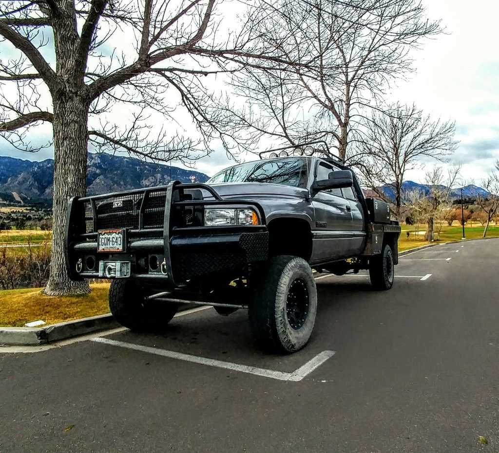

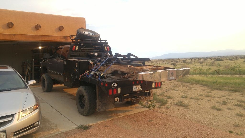

Now onto something a bit more involved. I ended up pulling off my big crossbox on top of the bed. No matter what I did to it with weather stripping, caulk, or any combination of the two, I could not keep water out of it. All of my tools were rusting badly. I was pretty happy I was able to sell it to a local guy with a similar flatbed. I hate scrapping usable stuff but I was tired of having oily hands from all the wd-40 I had on my tools to keep them from rusting. Switched to some 4'x1.5'x16" boxes from Northern Tool and have been very happy with them.
http://i1330.photobucket.com/albums/w577/GJStringert/0711161803_resized_zpstaqnfzv7.jpg
And if you're interested, tare weight on my truck is 8,400 lbs (been running a lot of stuff to scrap lately). That's a heavy monster!

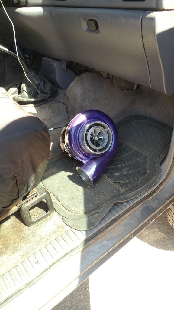

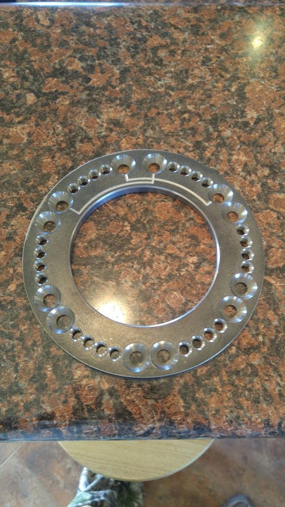

Ok, now to the really good stuff. So, if you remember from the first iteration of this rebuild (when I pulled the engine), I have an Aurora 3000 turbo, marine pistons, and Cummins marine 370 HP injectors with a minor timing bump and a #10 fuel plate. The truck has been running very well when it's unloaded, but lately, especially with the summer heat, my EGTs have been reaching 1300* pretty easily. That, and I'm after a bit more power. I have a good friend that had an Aurora 5000 for sale (71.5 mm T4 from ATS diesel), so I bought that off him to do a compound turbo setup, with my Aurora 3000 as the small charger. Currently, the truck is at PRT Diesel in Peckham having piping built and a bit bigger injectors installed. The end goal there is 600 HP with EGTs never over 1200* again. Obviously if I get stupid with it or I'm loaded REALLY heavy it'll climb, but I think this should be pretty driveable. I hope...
http://i1330.photobucket.com/albums/w577/GJStringert/0809161111_zpshzfamnc6.jpg

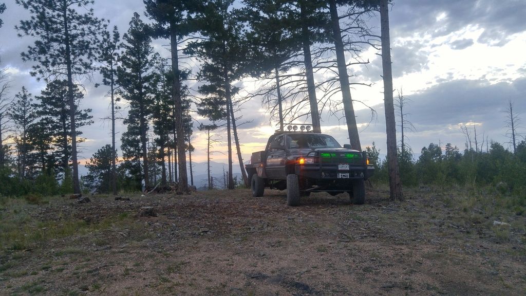

And that brings us up to date. Kaity and I have made it out to several overnight camping trips this summer up in the Pike National Forest:
http://i1330.photobucket.com/albums/w577/GJStringert/0715162048_resized 1_zpsefbsip9y.jpg
http://i1330.photobucket.com/albums/w577/GJStringert/0715162032_HDR_resized_zpsgyspdgu5.jpg

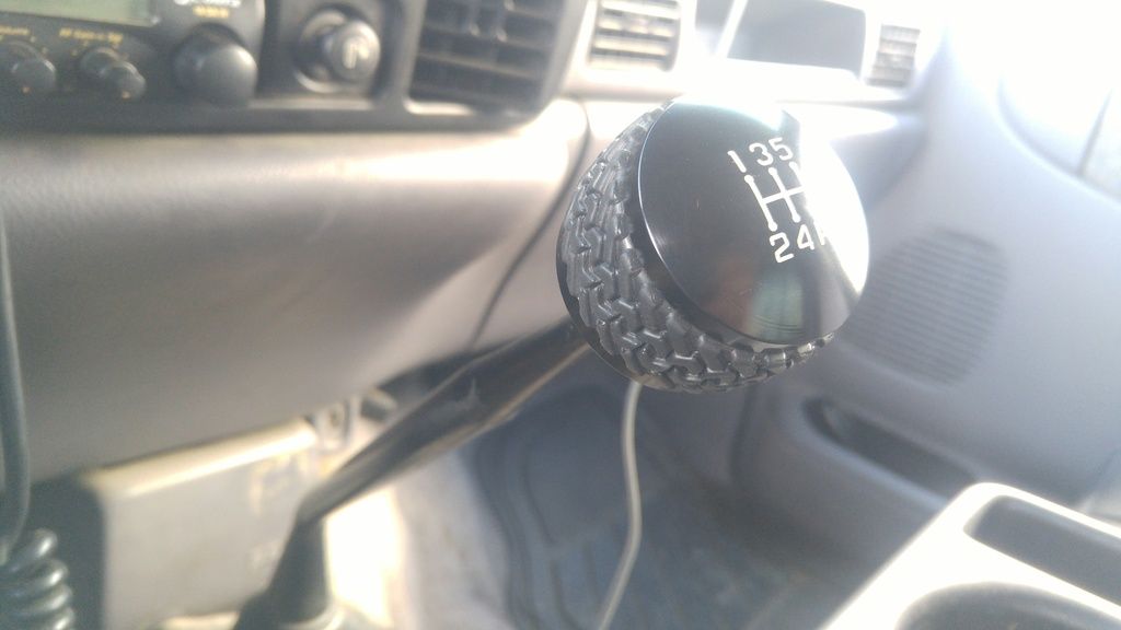

And I also found out that a Drake Off Road mud tire shift knob for a Jeep TJ fits the nv4500 perfectly!

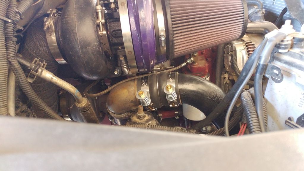

I'm very excited to say the old 12 valve is now compound turbo charged, and oh my lordy, this thing runs HARD.

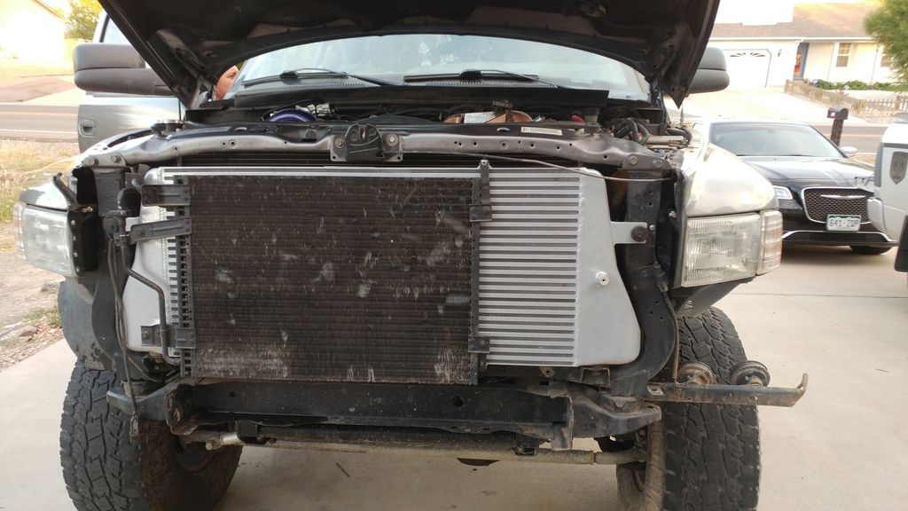

I've had the truck for about 2 months now, after the install, and I'll be honest, I had some issues at first. Chief issue was that the factory intercooler wanted nothing to do with the massive CFM the 2 turbos were pushing, and I blew several lines out of the driver side end tank. Installed a Mishimoto (kind of expensive, but a VERY nice piece), and some BD Diesel spring loaded clamps and boots, and we're relatively insured for a good amount of boost. I also ended up blowing the gasket between the intake horn and grid heater, and the gasket under the intake plenum on the head. Not a huge issue, pretty cheap, but that intake plenum one is a pain because you have to remove fuel lines to get to it, and re-bleed the lines afterwards. I pulled my hair out over this for weeks on end, trying to track down boost leaks. Ended up being pretty difficult because it's a stick shift and I can't load it up at a standstill (like brake-boosting an automatic), so I ended up just replacing gaskets and clamps here and there until I finally got it all sealed up. Re-torqued the head studs just to be safe, and only one took about a half turn to get into spec, so I should be all good in the head gasket department.
And some numbers:
At an unloaded 80 mph cruise, I'm at around 16 PSI and 800* EGTs. Unloaded, in 5th, from about a 50 mph roll to 80, I can get about 55 PSI out of the compounds, and I have yet to get the pyro above 1200*, loaded or not. That Aurora 5000 is an absolute animal. What's weird too is that the truck doesn't really drive like a diesel anymore. It feels like it has a much wider powerband, it almost drives like a gasser now, except that it has immediate torque off idle.
The only other thing I feel like I'm going to need is a lift pump of some sort, like an Air Dog or FASS. I'd like to try and keep it all mechanical, but as it is, my p-pump is completely maxed (AFC full forward, #10 plate full forward), and the turbos still outrun the fueling. It doesn't smoke at all, not even a haze, when the turbos are lit. But that's a modification for the future.
