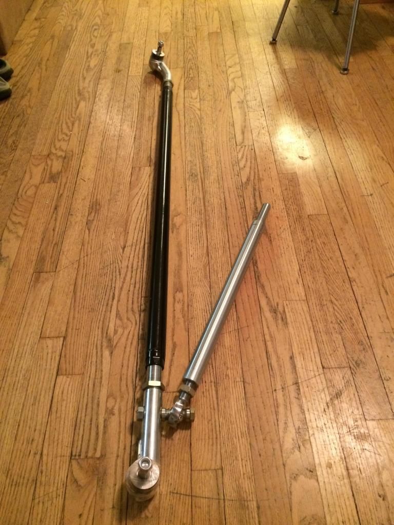

A while ago I started another thread asking about DT Profab parts. I cannot express how impressed I am with them. I ended up having to wait a bit to get my new steering linkage from them ( I knew this when I ordered, they were posted on the website as "backorder", no harm done), and the wait was worth it, their parts are very, VERY well built. I said this before, but I really wish I'd have known about them the first go around with this build, save me the headache and wallet-ache down the road. Over the last few months, ever since the death wobble incident on the highway, I have completely redone the suspension and steering on this truck, front to back. The only things I haven't replaced are the power steering pump and gear box, and they're getting replaced with the upcoming engine rebuild. No more screwing around…

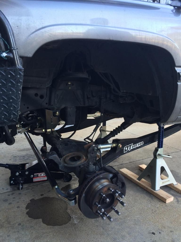

Here's the new spec sheet:
FRONT:
DT radius arms, steering box brace, track bar and bracket, and HD crossover steering.
Thuren 7" 3rd gen coils
12" travel Bilstein 5100s
14" Poly Performance straps

Those rear springs required a 6* shim because they absolutely trashed my pinion angle at first haha! My fault, didn't really take the shackle flip into account ahead of time.

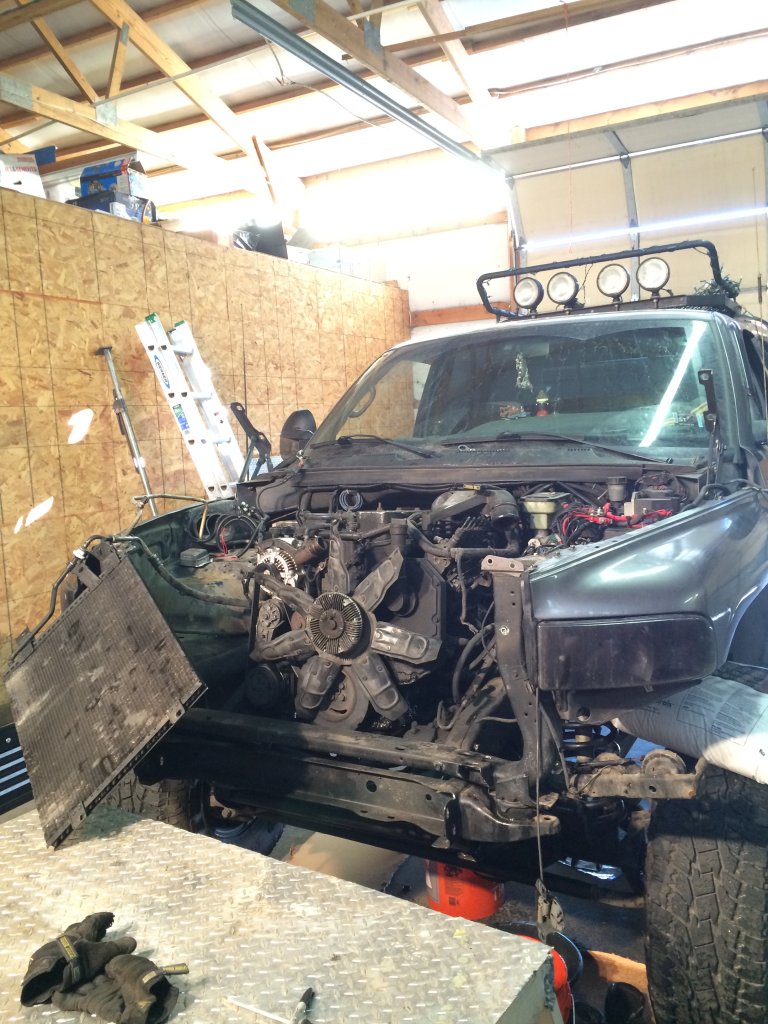

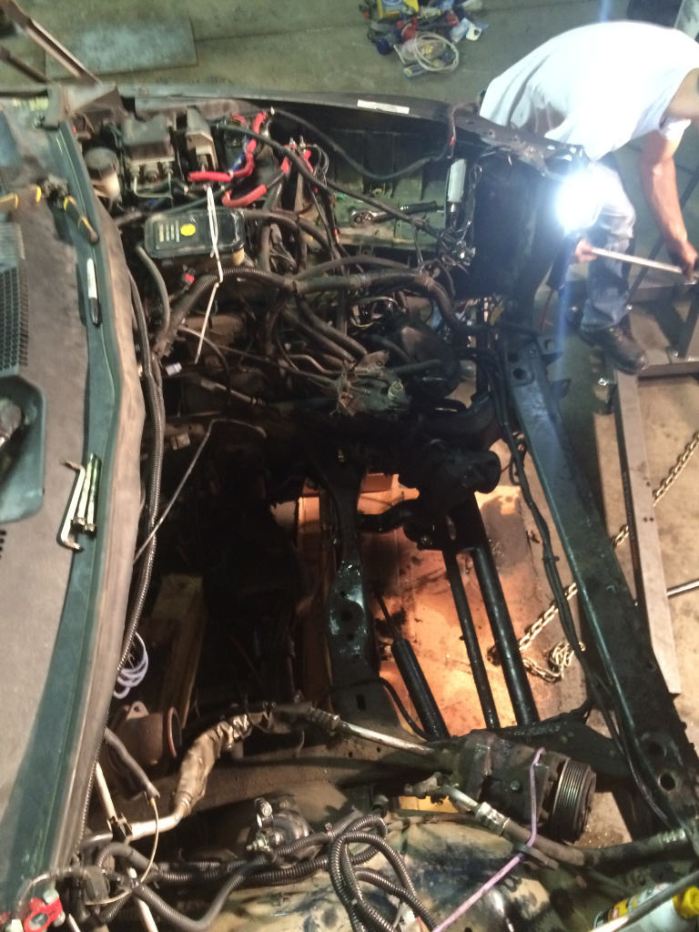

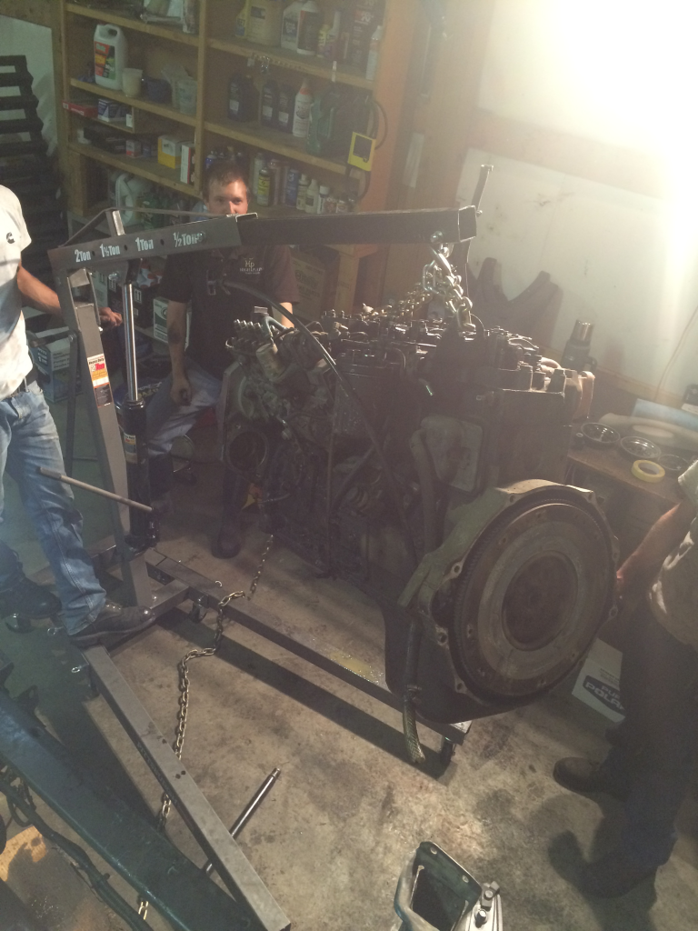

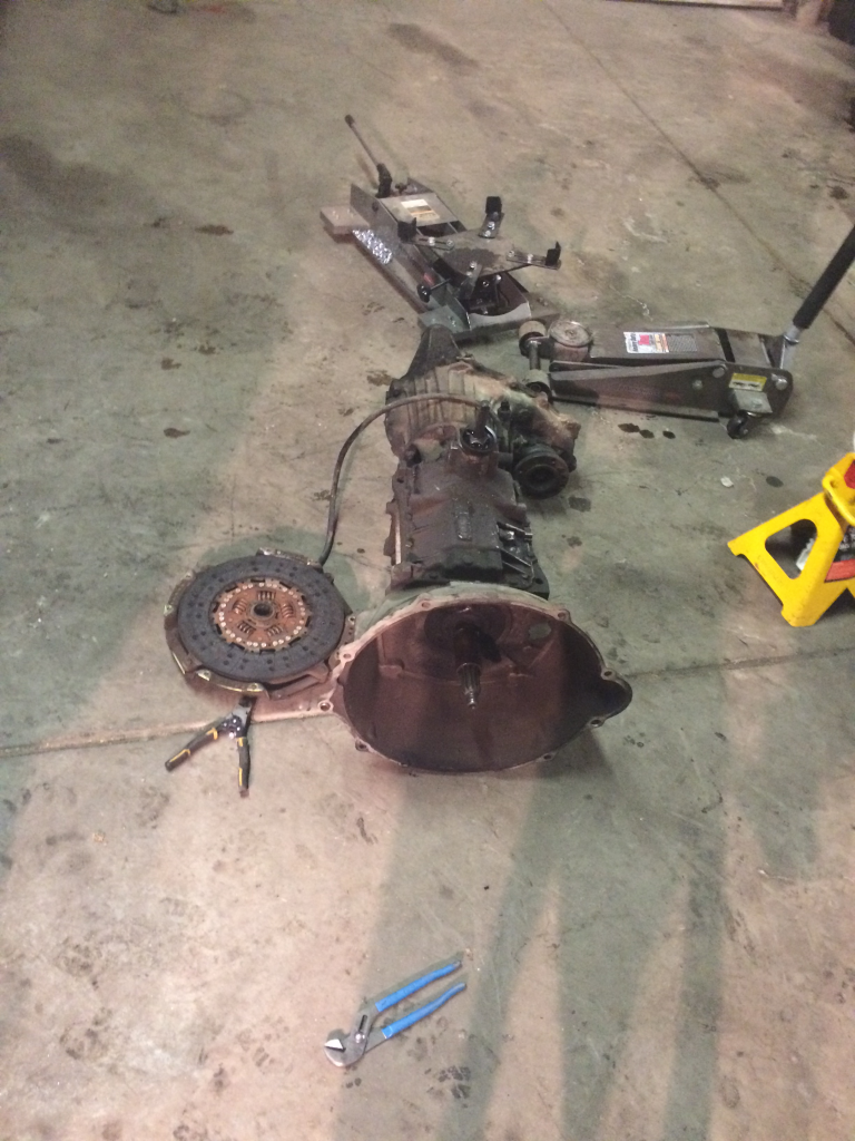

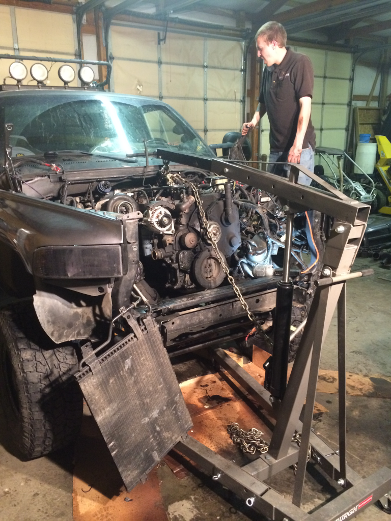

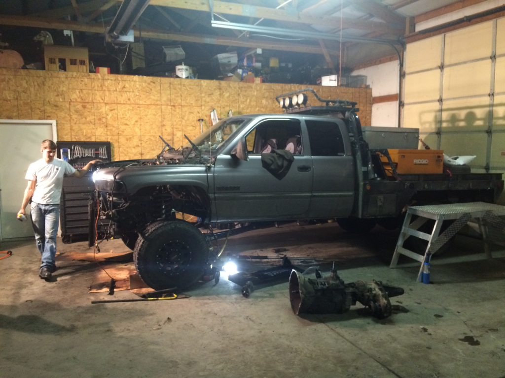

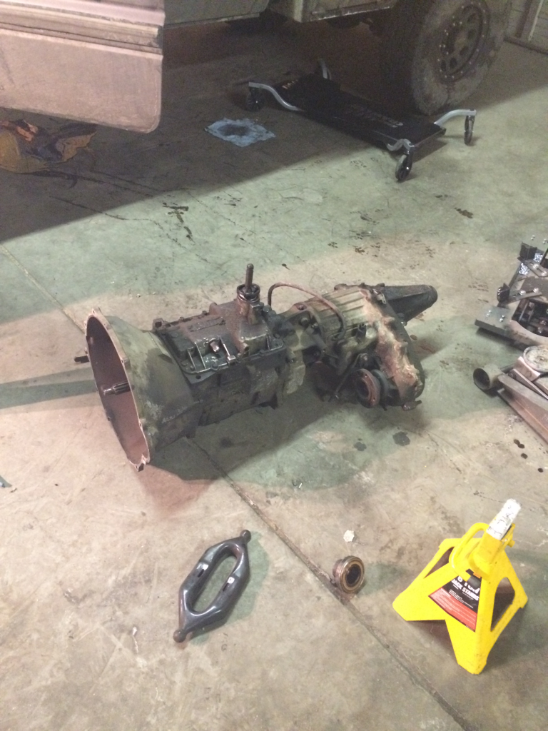

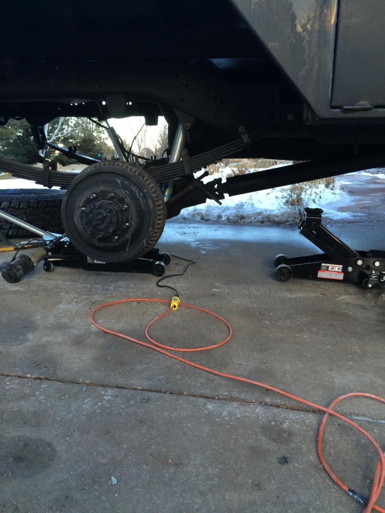

Yesterday we pulled the entire drivetrain out of the truck. I told the engine builder I'd have him my block by the 9th, we're right on schedule! I'm going to be honest, I don't know how this truck was running as well as it was for the last year and a half. The radiator was all kinds of clogged (perhaps my own fault, never even got around to flushing it after the heater core incident last year), power steering worked when it wanted to, and WOW, the tranny was running on a prayer. Flywheel is cracked in several places, and has that purple-ish over-heating color change in several spots, and the clutch probably had 1000 miles left on it. I mean, wow, this thing needed help...
The pictures tell the story! I worked on pulling the radiator and all the front stuff off, then when my friends were off work it took the 3 of us about 6 hours to drop everything, so maybe 7-8 hours total. I picked up about 4" of lift in the front with my bumper and winch off, and the engine out. It's been said before, these Cummins are HEAVY with a vengeance.
And note my awesome prerunner rake I have now. My 35" tires are almost under the cab.
So I need to have this thing worked over, it's in a lot worse shape than I ever thought it would be. The transmission is what blew me away, I'd have thought I'd be able to "feel" if anything were going out, and yah, it's pretty sloppy and has some bearing whine, but the clutch and flywheel are so much worse than I thought they'd be. The good news is it's all out right on schedule and it'll all be nice and fresh when I get it back. Now, I wait...

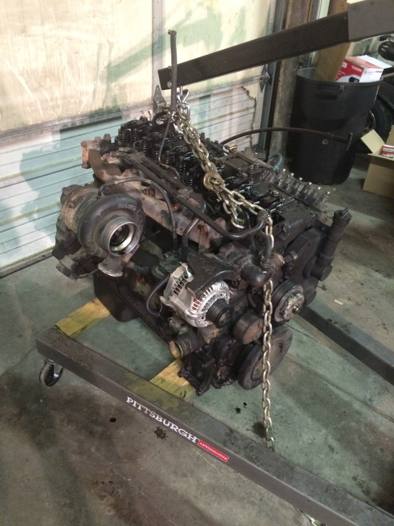

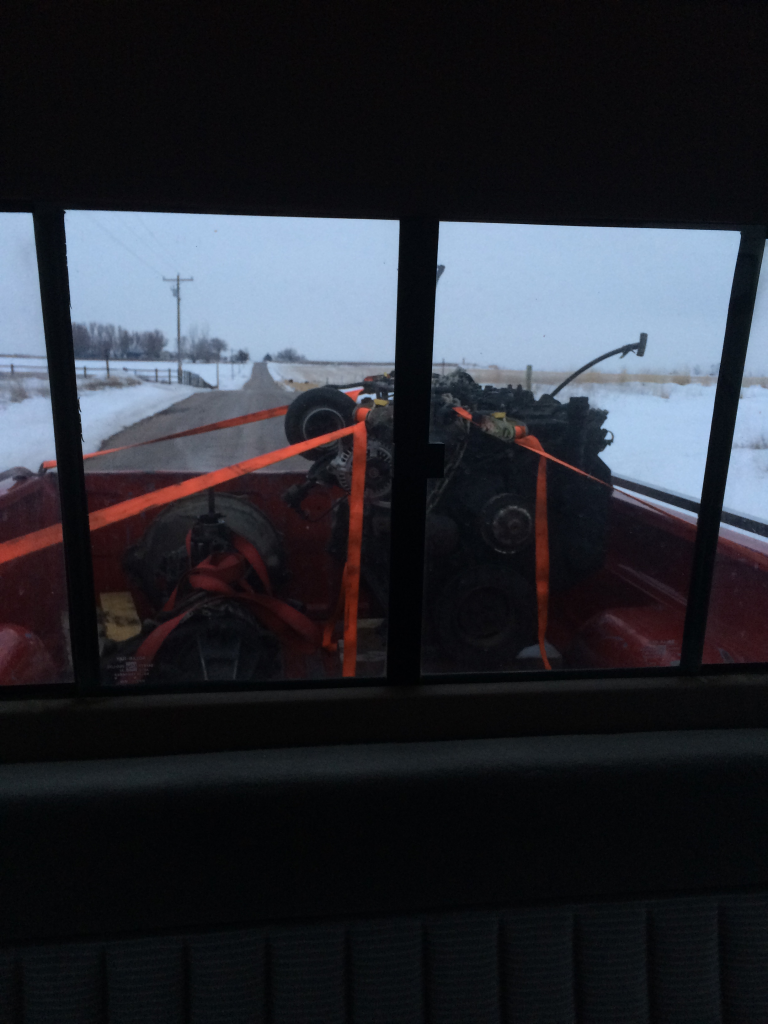

I took my engine/tranny/transfer case to my builder last night. The engine I had in my truck, I'm finding out, is pretty rare: it was built in late 1997, and was a 53 casting (for those of you familiar with the 53 block 24 valve Cummins and their related issues), but it was a 53 cast 12 valve "Encore" block, similar to a STORM block, with the 2 different turbo oil drain bungs. While rare, it's still a 53 block, and after a lot of talking with my builder, we decided to scrap the 53 in favor of an earlier 12 valve block, without the water jacket cracking issues. It'd be a nightmare to build my 53 block and have it crack later down the road. Here's the proposed build:
-Rebuilt 1997 Cummins 12 valve industrial engine (I believe it was out of an industrial air pump or something, 14mm main bolts instead of 12mm, and some other minor differences. It was actually cast by International Harvester, which is kind of unique)
-ARP 425 headstuds
-Marine pistons and injectors (roughly 60hp over stock)
-ATS Aurora 3000 Turbo (~2mm larger than factory), 3-piece manifold
-KDP/Plated Rear Freeze Plug
-Rebuilt P-pump: #10 plate, 4K gov springs, little timing advance, stock delivery valves
There's some stuff I'm forgetting, but this is the stuff that comes to mind. I told him my goal horsepower is around 350-375, I'm not looking to make a hot rod but if you've driven a factory-spec 12 valve you know they can hardly outrun themselves. He sort of laughed when I told him that because he said, with the parts going into it, and the proper pump tuning, he could get me as high as 500 HP. After I picked my jaw up off the floor, I had to tell him to keep it relatively mild. I'm trying to keep some fuel economy here too haha!
The transmission is getting worked over big time: new single plate clutch, all new syncros (3 and 4 were absolutely gone in my tranny), fixed 5th gear nut, re-sealed, and a fresh coat of paint.
I left my transfer case attached, and hadn't planned on having that rebuilt or anything, but it leaked like absolutely crazy (where the 2 case halves met up), so he offered to run through it and reseal it for me. May as well, it'd be dumb to push 375 HP through an old non-rebuilt case and blow it to pieces.
