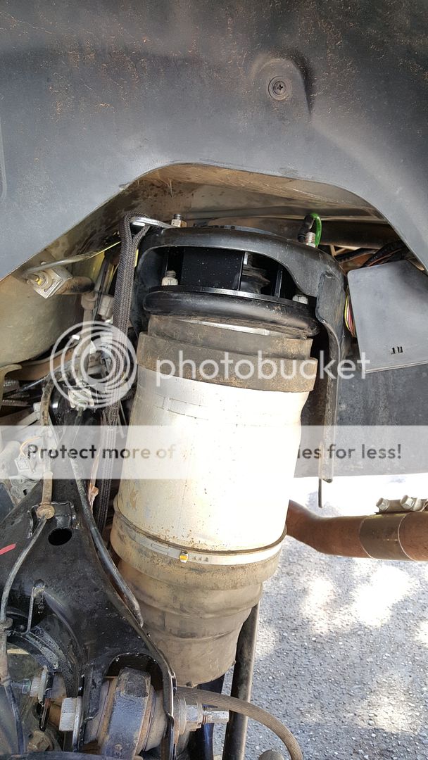

Now install the spacer to the top of the strut. Feed the short black airline up through the provided hole in the spacer and use the original 3 15mm nuts to secure it. On the rear, you’ll need to place the strut back loosely in place prior to bolting on the spacer. On the front you can do it outside the vehicle then put the strut back in place.

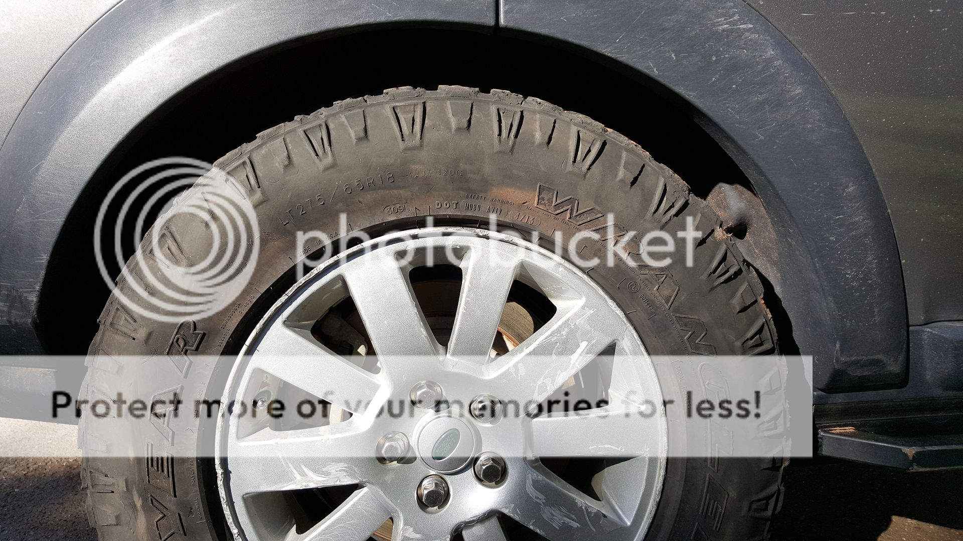

With my tuck sitting on the bump stops I measured 17.75” from wheel center to the bottom of the wheel arch at the rear and 18.75” at the front. I didn’t bother measuring from the ground to the wheel arch or over-all height as that will vary based on the tires you are running, but you can use that number to calculate your own truck’s new minimum height. There is plenty of clearance in the wheel wells now for my current 275-65-18 Duratracs when on the stops. As soon as they arrive at my local store, I’ll be fitting 275-70-18 Cooper STT Pros which are listed at 33.31” diameter. Though I may need to do some extra trimming here and there, the extensions should still keep the tires out of the wheel wells in a failure.
Front spacer installed:
Rear spacer installed:
Front wheel clearance on the bumpstops:
Rear wheel clearance on the bumpstops:
Over-all view on the bumpstops:

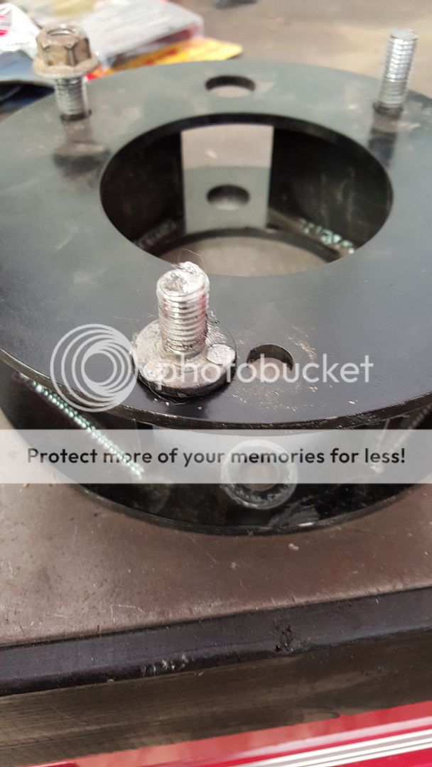

I should say I did run into one snag. On the rear I wasn't sure where the limit strap attached so I went ahead and mounted the spacers then once I figured out where the strap went I came back to install it. When removing the supplied lock-nut, it galled and I snapped the stud off of the spacer. There was almost enough thread left on the stud, but instead of messing with it I instead drove the broken stud out and tack welded a 10mm bolt back in its place.
The broken stud after removal:
And the new bolt tacked in place: (clearly I am not a professional welder)
